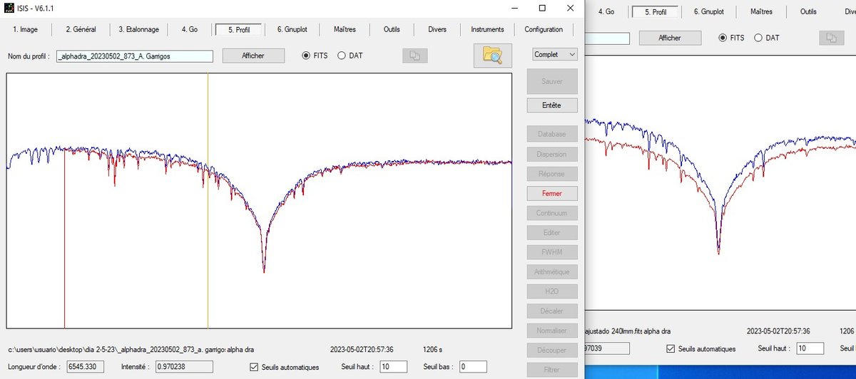

I had a problem with the instrumental response, it was because I have my files in ".FITS" and the reference spectra are in ".FIT", when selecting the reference spectrum it gave me an error "not found" I have activated before clicking "Réponse" in ISIS the extension ."FIT" ok.
Now my spectrum adjusts much better to that of another partner (full image), they almost overlap. You always learn something new.
Greetings.
