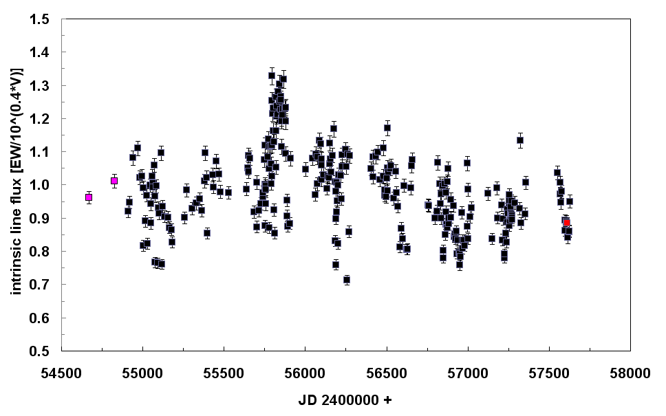

by Ernst Pollmann
Jean-Jacques,
here comes the EW and intrinsic flux evaluation of your spectrum.
As you can see, everyting fits very well!!
pcyg_intrinsic flux.png (19.28 KiB) Viewed 26821 times
Ernst
