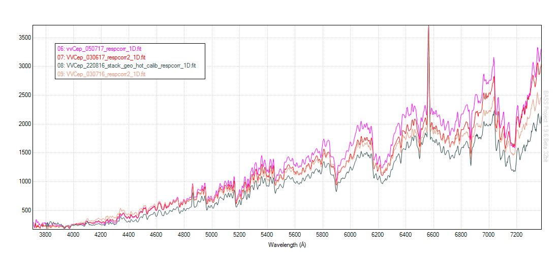

Broadly speaking the Hα emission seems to be fading since my first observations last summer 2016, even since this June. Could the processing of the spectra be a factor rather than a real change in the Hα intensity? I attach a composite of the 4 spectra I have obtained since July last year. They are vertically aligned on the Hα emission maximum. My set-up: 8" Meade LX90 at f6.3, Alpy 600 with 23µ slit, Atik 314L camera. For the June and July 2017 spectra I used nu Cep as the calibration star. I used different calibration stars for the 2016 spectra
Hugh

Thank you very much for the link to your paper, I very much enjoyed reading it. I estimated the FWHM and EW values from my 4 spectra:
FWHM, Å EW, Å
2017 05-Jul 11.7 -8.6
2017 03-Jun 11.2 -10.7
2016 22-Aug 11.5 -13.3
2016 03-Jul 11.2 -11.9
I would say the equivalent widths are not rigorously derived (I did not normalise the spectra) and of course unlike in your paper there is no correction for any variation in magnitude of the supergiant. But the general range of equivalent widths across the set of observations looks to be consistent with the range in your paper (figure 3) so maybe my mistake is to draw a trend of weakening Hα emission based on too few data points. I really appreciated your feedback, thanks for taking the time

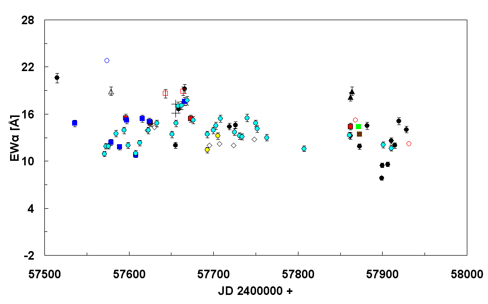

by Ernst Pollmann
Hugh,
the enclosed plot shows you the meanwhile more supplemented time behavior from July 2016 to now. So, here you can immediately estimate the level of coincidence with your EW calculation of your non-normalized spectra.
But in the sense of a better comparability I would recommend to normalize your spectra.
Ernst

Hi Hugh,
Just a side note.
Carefully looking to the blue part of your spectra, the orange line is on top, while it is in the middle in the red part, for example. So I suggest there is tilt of the continuum slope.
My first impulse was thinking it should be a problem of color calibration due to different height above horizon and causing atmospheric extinction. This effect is known to tilt the slope of the continuum.
In astronomical photometry, the blue and red part of light, esp. the ratio of the different parts in color spectrum, will vary with height of the target above horizon. Atmospheric (color) extinction is amplified, if the calibration star and the target have been observed through different air mass. The effect is also observed to have seasonal influence (Gutiérrez-Moreno et al., 1982). The effect should also have a significant influence on observation of the eclipse. Therefore, a careful selection of the reference star and time of observation to calibrate the instrumental response is important.
Conclusion
Instead of using the H-alpha intensity for comparing spectra, try to normalize spectra based on continuum intensity to study possible reasons of the effect. If you want to study H-alpha intensity only, normalize spectra based on the base level of the continuum around H-alpha.
Literature
Gutiérrez-Moreno, A., G. Cortes, and H. Moreno. A study of atmospheric extinction at Cerro Tololo Inter-American observatory. Publications of the Astronomical Society of the Pacific 94.560 (1982): 722.
http://adsabs.harvard.edu/abs/1982PASP...94..722G
Good luck,
Thilo

Hi Thilo,
I am not yet convinced from these plots that there is necessarily an extinction (or other instrument response) problem here as the effect should be seen more severely at the blue end with little difference at the red end, though I agree it is difficult to see from these differently scaled plots.
Hugh,
Since relative flux units are arbitrary and have no physical meaning, It is good practise to always scale plots in relative flux to 1 relative to some specified point in the continuum, typically 5500A is used for example. (confusingly this is often called normalising but strictly it is just rescaling. Strictly normalising (rectification) is where the continuum is divided out so the continuum is 1 at all wavelengths) With a cool stars it can be difficult to pick a suitable continuum region. I would suggest in this case normalising relative to the average value from 6050 to 6150A say for example and comparing the spectra again. (ISIS has a function to do this, also it is easy to replot and compare spectra even if they are not scaled the same using Tim Lester's PlotSpectra program)
Re: VV Cep evolution at low resolution
Posted: Sat Jul 29, 2017 4:10 pm
Hugh,
Your EW measurements should be valid independent of any flux scaling factor as the calculation of EW is done relative to the local continuum. The result can be very sensitive to how this continuum is determined (either manually or by the software)however and is particularly difficult at low resolution in cool stars like this where the region of interest contains so much structure and blending of lines. I would say this is a case where the uncertainty in your EW measurement is likely to be large compared with measurements made at higher resolution.
Posted: Sat Jul 29, 2017 5:01 pm
Where low resolution spectra could be useful however is to test Ernst's assumption in his paper that changes in the flux in the V band can be used to correct EW for changes in the continuum flux at H alpha. This is not clear from the paper currently, since if the variations in brightness are pulsation (and therefore temperature) driven, one would expect the flux changes to be less in the continuum around H alpha compared with in the V band.
