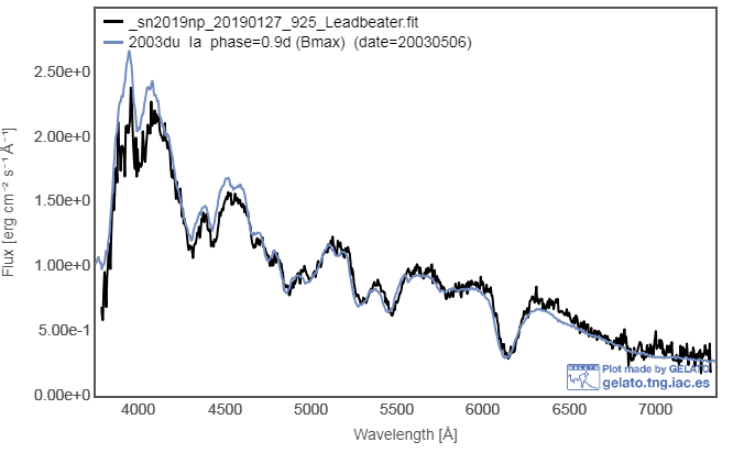

Now at mag 13. An ALPY 600 spectrum from last night and match to a Ia at maximum from GELATO
