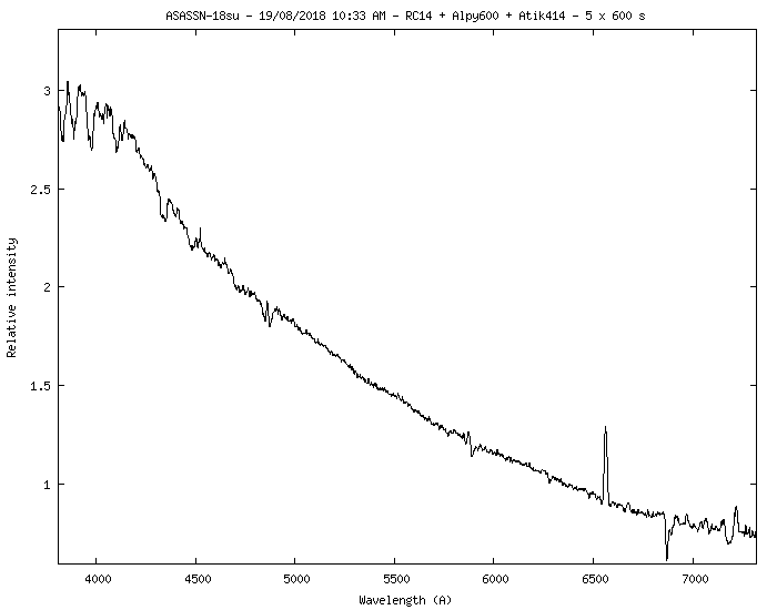

Re: Bright Tanscient (mag 10): ASASSN-18su
The spectrum obtained by Paul Luckas
Cleraly a dwarf nova in outburst
Comments about the spectrum, by Steve Shore:
It's interesting that He I 5876,6678 are in weak emission (oddly there's no 7065), the emission is centered on, and about the same width as, the Halpha; there might be a hint of something at 4471 but not much. The Balmer decrement is very steep, there's no He II that I can see (or, rather, that we'd believe) and the Balmer spectrum is very strong. It's cute that this looks like a cataclysmic but the lack of He II is suspicious. The Halpha/Hbeta ratio is about 12, which would be normal for a heavily reddened object ut not this so, again, I suspect a disk (this isn't recombination). The FWZI for both emission lines is about 1600-1700 km/s. The same is true for He I 5876. The Na I D is weaker than I'd thought, going backover your spectrum and including the effects of resolution it wouldn't make he line so unsaturated so I think this agrees with what the XR picture is giving, that the neutral hydrogen column density is small. It might, in fact, be a Gaia source; there's a 17th mag source at the position within 5 arcsec but there's an offset, it has a parallax of 5.5 mas so this would be right for a cataclysmic).
