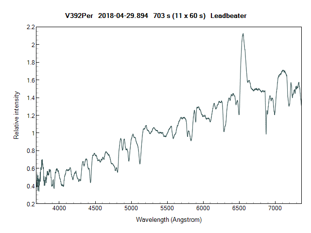

ALPY 600 spectrum of V392 Per in outburst (R~500)
It looks a very strange spectrum to me but I don't really know what to expect for this sort of object !

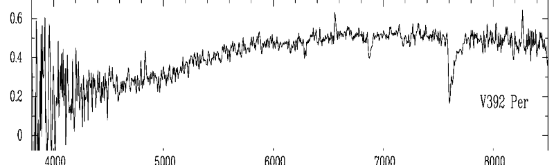

Found a reference spectrum for this object here from 1998 when it was v mag 17.4. It is ~11 magnitudes brighter than this currently !
http://iopscience.iop.org/article/10.1086/313380/pdf

You have been mentioned on Atel#11588 having similar spectrum!

Confirmed as bright nova
http://www.astronomerstelegram.org/?read=11588
Of course, more spectra are welcome. This one could be fast.

Despite some difference it looks to be similar with SN2017eaw (see survey in that forum).
Many thanks for that alert.

Great catch Robin,
Following the last year work on SN2017eaw a rough and dirty evaluation of your excellent data shows an hydrogène Ha expansion speed around 2600kms.
Everything is going fast and this is already confirmed with more details on http://www.astronomerstelegram.org/?read=11588.
Congratulation and thank again for that alert. An excellent target for Alpy but weather condition are presently difficult here in Toulouse.
Daniel

I should add that, for SN2017eaw such global pattern arised around 70days after origin (+/-10days). If this is also true here, that mean this outburst is going on since a couple weeks. Interesting to note it has just been discovered despite all attention of astronomers around the world.
