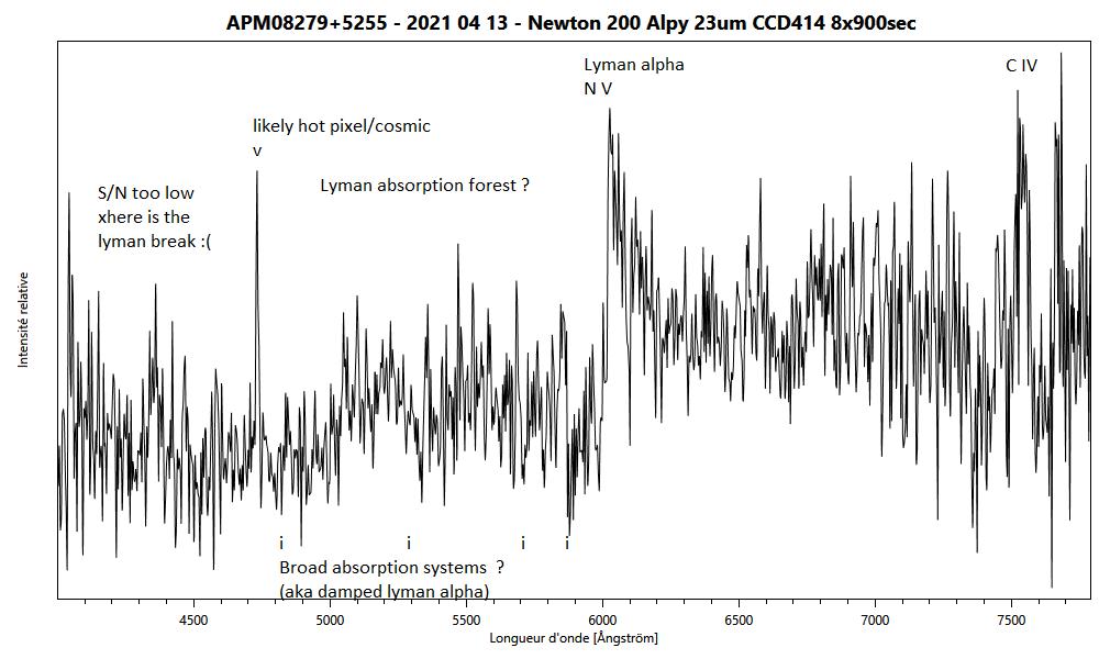

Here is the classic lensed broad absorption quasar APM 08279+5255 yesterday night with a standard Alpy and T200 Newton near downtown Toulouse
With a quick reduction in Demetra (could optimize in Isis ?), the spectrum is too noisy to clearly see broad absorption systems in the lyman forest. Nor the lyman break.

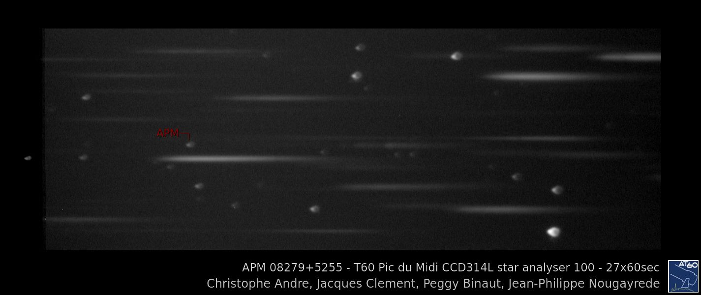

Funily, a quick spectrum with a star analyser on a T600 under dark skies (Pic du Midi) produced a better result
