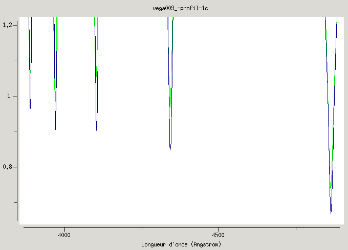

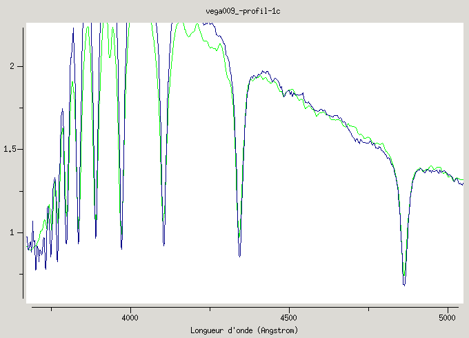

As calibration lamp spectrum has the fishtail and other geometric defromations as yours stellar spectra, calibration law computed with lamp contains information adapted to the spectra taken before or after the lamp spectrum.
Today I answered Etienne (http://www.spectro-aras.com/forum/viewt ... 5688#p5688) about Alpy calibration and his Vega spectrum's shape (Planck continuum).
I did a quick processing of his Vega spectra (A0V type) with 6 Ar-Ne lines coming from his lamp spectrum well spreaded over the whole spectrum (see link above) giving a third order calibration law (upper order is quite instable and not so accurate at edges).
As you see, superposed Pickels spectrum (green) on Vega's spectrum (blue) shows quite good calibration at blue end.
Anyway, using more lines would give a more accurate calibration law.

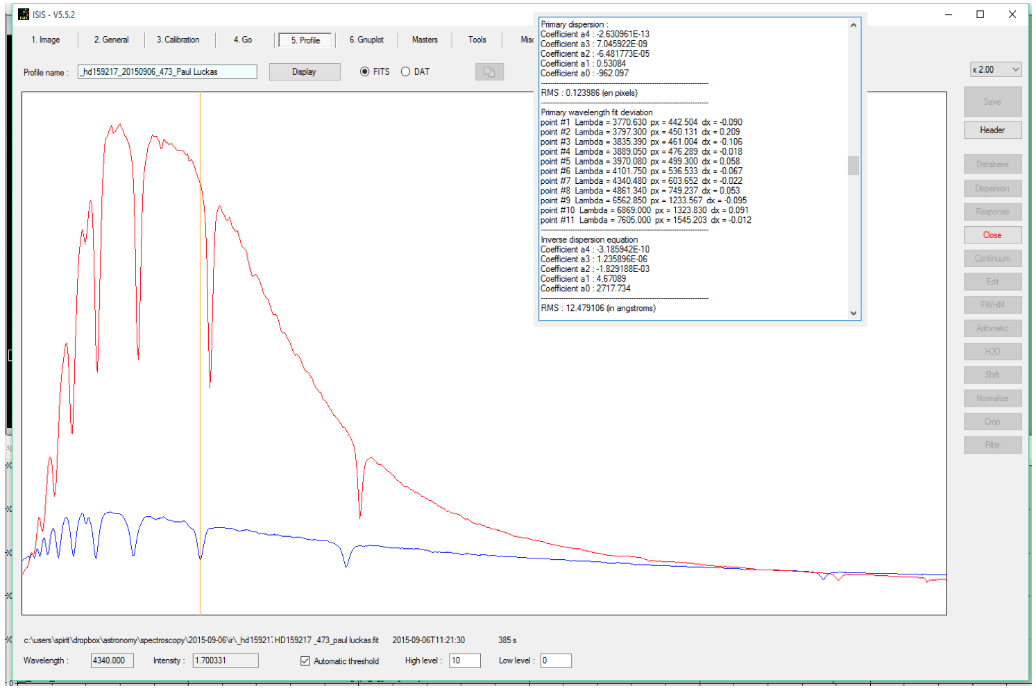

It's not a show stopper, but I'm curious as to why I am unable to get a good result using the predefined Alpy calibration mode in ISIS. Why such a large RMS ?
ISIS Predefined mode using calibration module (1 line)

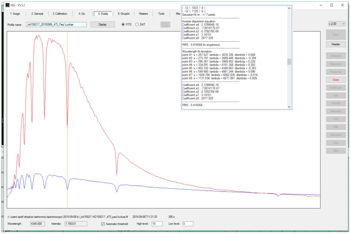

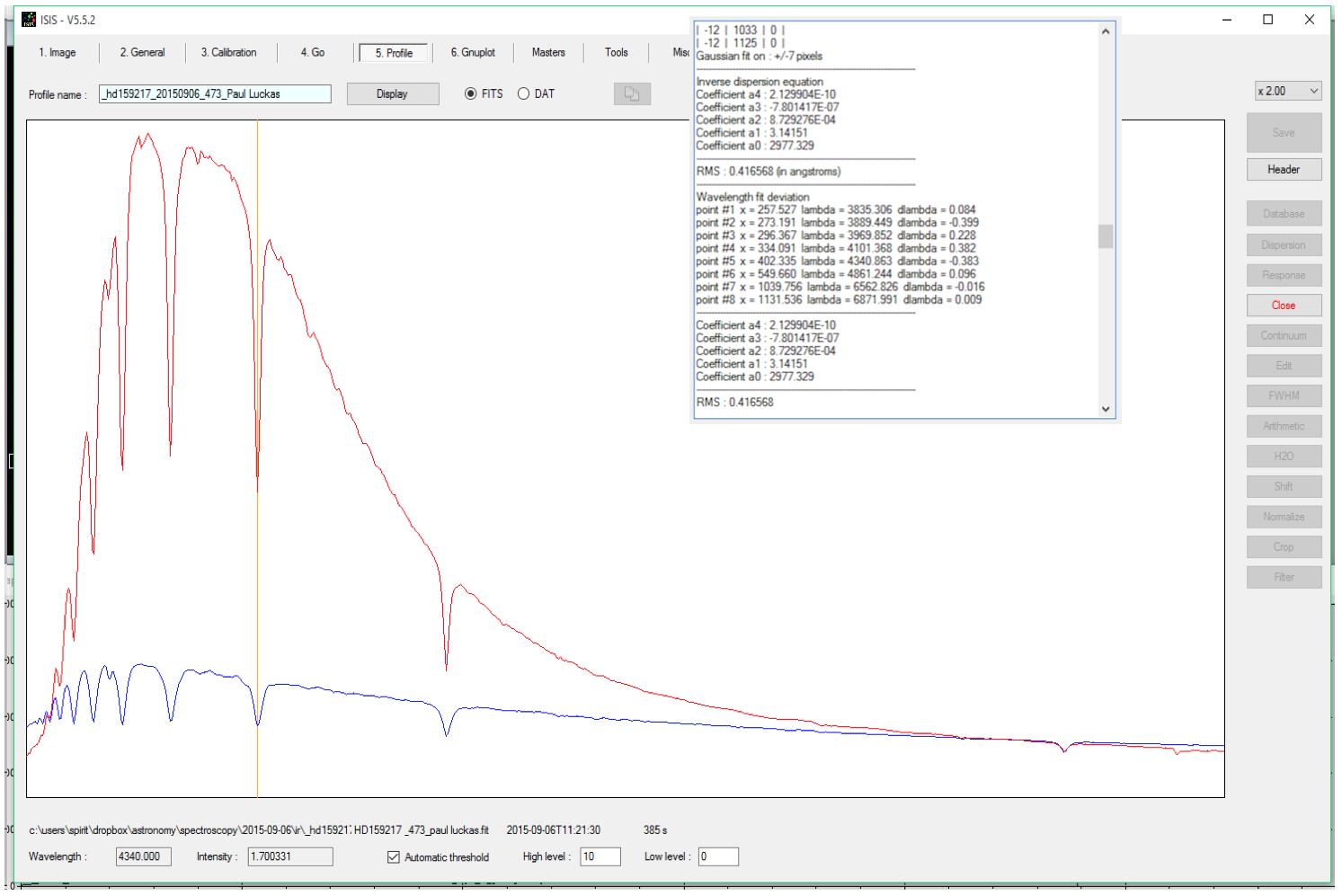

The Balmer line calibration method gives me a very respectable RMS = 0.4.
ISIS Predefined calibration mode using Balmer line

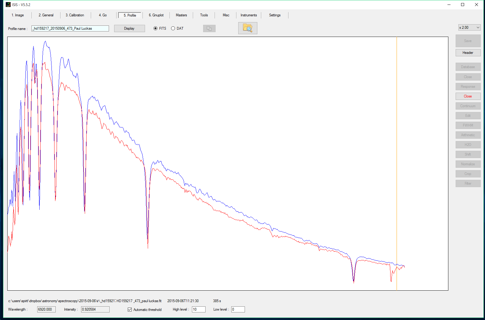

Finally, here's a result using predefined dispersion from upwards of half a dozen lines from 4200Å to 7635Å (and IR corrected this time).
Paul.
