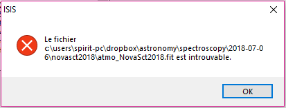

I've used AOD successfully in the past, but in recent times I get an error reporting a missing file (see attached example). The issue seems somewhat intermittent.
Any advice gratefully received.
Paul

Bonjour
je lis "dropbox" dans le chemin d'accès au fichier atmo
le serveur de ce cloud a un temps de latence beaucoup plus long qu'un disque local
mieux vaut définir un disque local pour répertoire de travail

Thanks Gerard,
That Dropbox folder is actually on a local disk (ISIS is reading and writing to a local disk, not to the cloud).
I guess it could be worth trying a different location to see if it makes a difference, but it has worked for years this way - so I'm not convinced that is the problem.
Paul

Solved. Spaces in the folder name.
