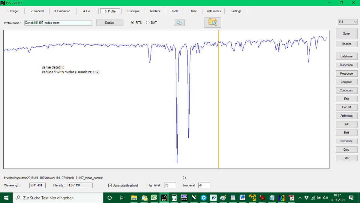

Bad efficiency of the eShel from shelyak

I am not at all happy about this, I would prefer to go on with ISIS since Midas is not so easy to use.........but at the moment I have no choice!

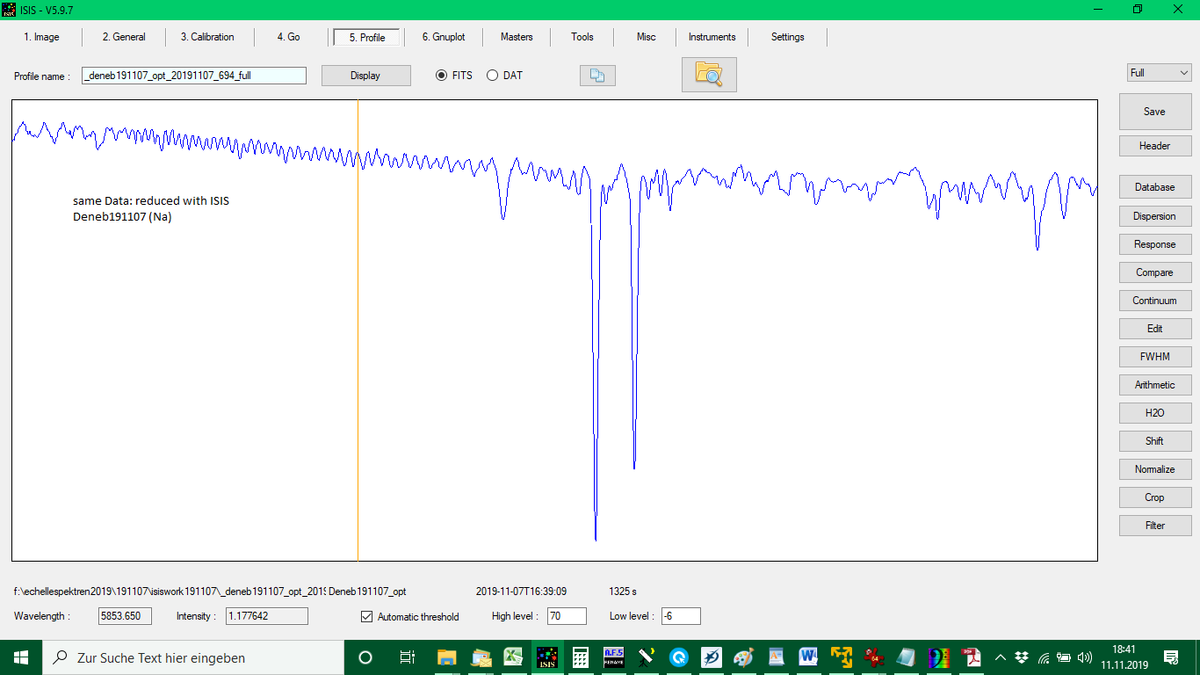

Hi Berthold,
In the screenshot of the ISIS main page, you checked:
- Sum before
- Median Filter
- Function de blaze lissé
When I process my eshel spectra (with an ATIK 460ex CCD), I check only :
- Optimal Binning
- Cosmic Rays filters
Do you use a CMOS camera ?
Christian wrote a page that explains the checkboxes
http://www.astrosurf.com/buil/isis/eshe ... index.html
- Sum before
- Median Filter
- Optimal Binning

- Posts: 1431
Re: Bad efficiency of the eShel from shelyak
Hi Berthold,
Unselect the option "Median filter" and compare. The problem is here, I suspect.
The median filtering option is only for very well sampled spectral (typically eShel spectra taken by using small pixels CMOS camera).

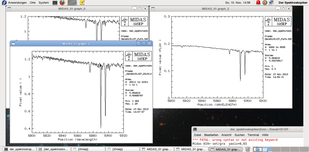

I have had an ATIK 460ex to avoid those ripples. No effect. The same probleme was to see as demonstrated with the 460ex! That is not caused by the detector! Please see the results with MIDAS!
berthold
berthold

there must be a problem with ISIS
unfortunately I can't send *.xml
that's not a probleme of the hardware.
berthold
- Posts: 35
- Joined: Thu Apr 21, 2016 8:15 pm
I overlooked the message of Christian, I don’t know why. Please excuse me.
Martin Dubs pointed this out to me once more, not to use the “median filtering” .What I don’t understand: I used at time CMOS detectors, but it was the same.
Berthold
Berthold
