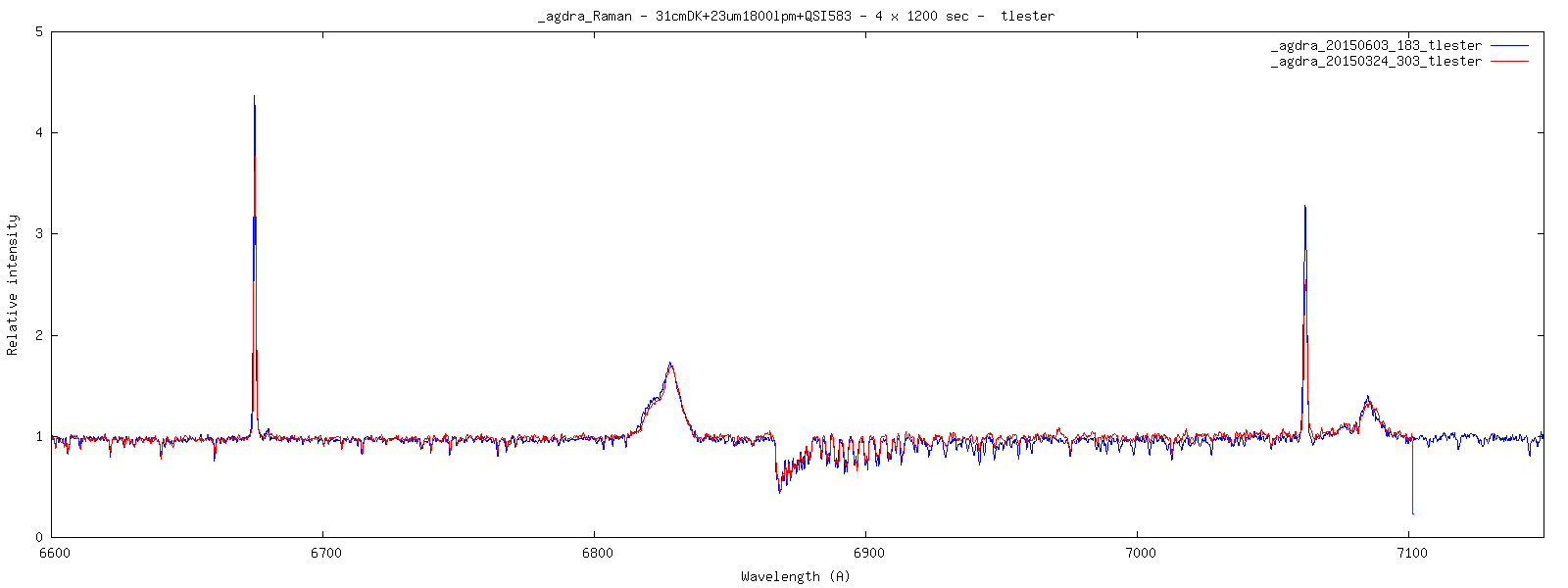

Re: AG Dra in outburst
Post by Tim Lester »
AG Dra for June 3rd compared to my last shot on March 24th (corrected for heliocentric radial velocity).

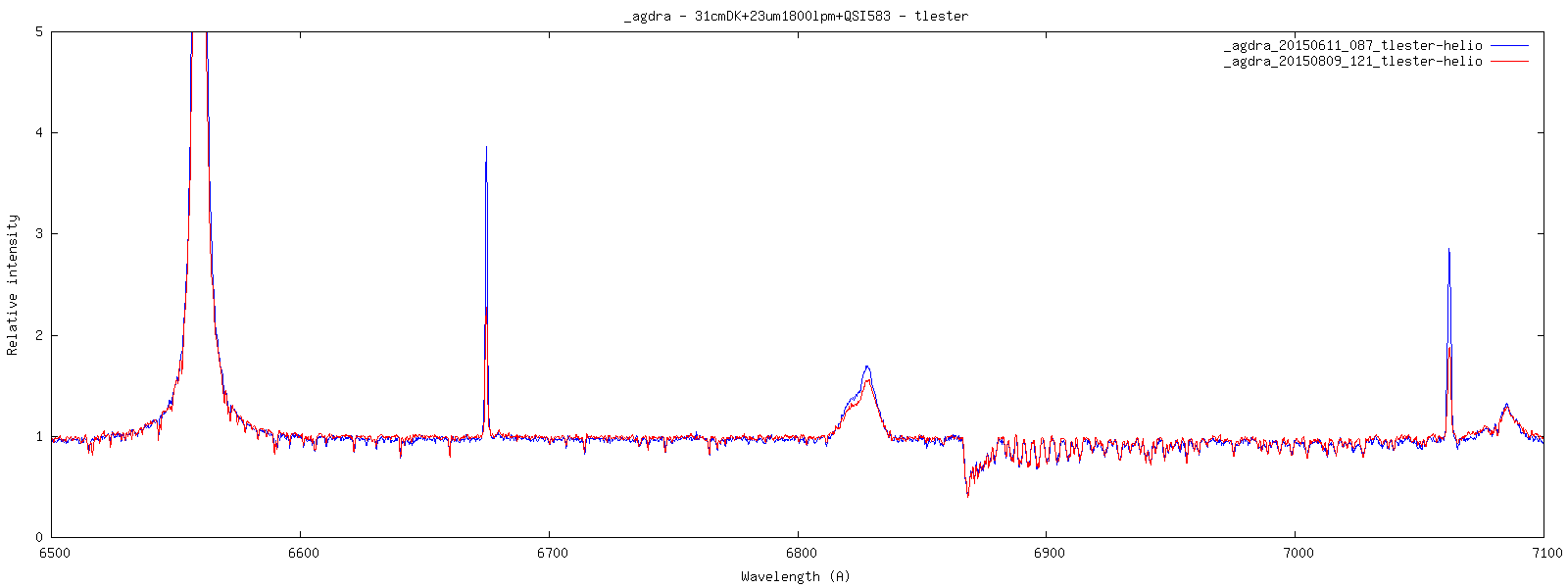

AG Dra for 2015-08-09 compared to my last result on 2015-06-11 (R=9000)
