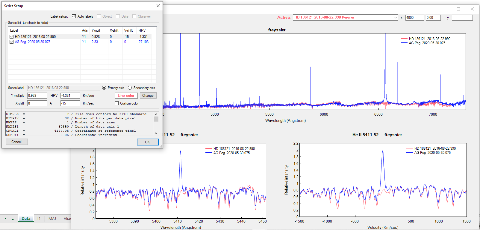

Here's an example
The comparison of AG Peg and HD186121, a M2III normal giant
Both have been corrected for HRV
I have shift the HD186121 spectrum by -15 km/s (X-shift) in order that the absorption lines matches with those of the continuum of AG Peg.
This avoid confusion, keeping HRV values.

I confirm Robin's answer.
The HRV is extracted from the header.
The change of HRV and X-Shift values have the same effect.
Here's an example
