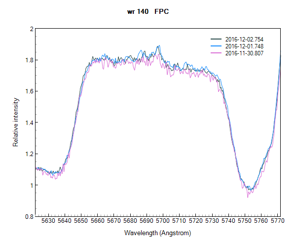

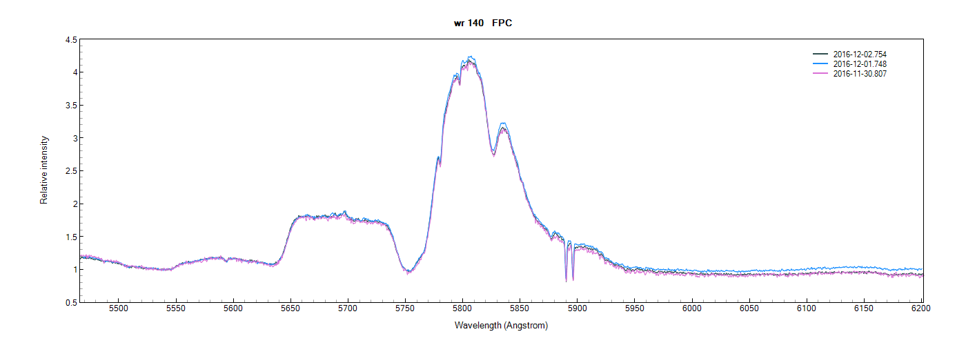

congratulations to everybody for your excellent spectra. Here you are the result of three consecutive nights. All spectra taken with the DADOS (1200 l/mm, R=5200-5700) operating through a newton 8". Exposures of 5x1200" (except the first night, 3x900" with bad seeing).
wr140_ 20161202_754_FPC amp.png (35 KiB) Viewed 9956 times
Also, I wonder where can I upload these fits.
Clear skies!
Fran

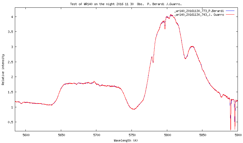

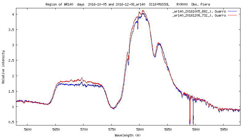

I believe that together, we are getting good results with the ER140.
I leave you with a graph of test reliability of the observation Paolo Beradi and one of mine.
Also a graph of 10 days in 2016 05/2016 12 08.
Regards, Joan.
_test wr140.png (6.59 KiB) Viewed 9903 times
