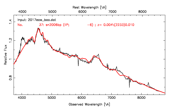

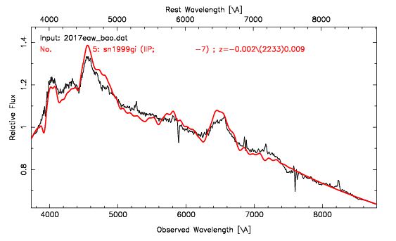

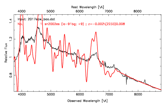

Usually I find SNID works better than GELATO but I tried the BAO spectrum with SNID and it favoured type 1a-91bg spectra at 9-17 days after maximum with good confidence. The fits do not look very good to me though and we know the supernova is younger than that :?
Here is the best fit according to SNID
The best type IIP fits look better to me though and the dates (6 and 7 days before maximum) are more sensible

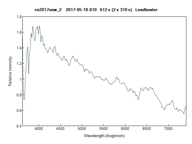

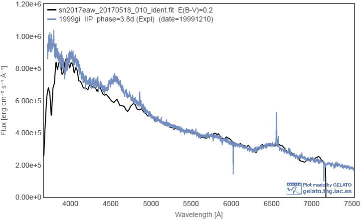

with my spectra, i find type IIP with 3.9 days :

Excellent achievement Etienne! Concerning your question about finding the minimum of P-Cygni absorption wavelength I think it's a bit risky relying on a particular peak when the random intensity fluctuations are of the same order of magnitude. Anyway, observing the continuum trend in that area, I think it shouldn't be too far from the point you found.
Maybe you already know, here you find a "classical" table that shows the main Sn types:
http://supernova.lbl.gov/~dnkasen/tutor ... _types.jpg
On the bottom the type II with the P-Cygni hydrogen alpha line composed of a broad emission and a narrower blue-shifted absorption. It is just a guideline, each case is in fact different. At present, the emission component of SN2017eaw is the large "bump" well visibile in your spectrum while the blue-shift absorption is difficult for me to identify even on the BAO profile. In the next days/weeks we'll see if the feature becomes appreciable. Expansion velocities measured with P-Cygni tend to decrease over time, so the absorption will be closer to the emission component, either way, it could become more pronounced.

Gelato indique une relation : Type Ib/c mais ça ne colle pas avec les phases.

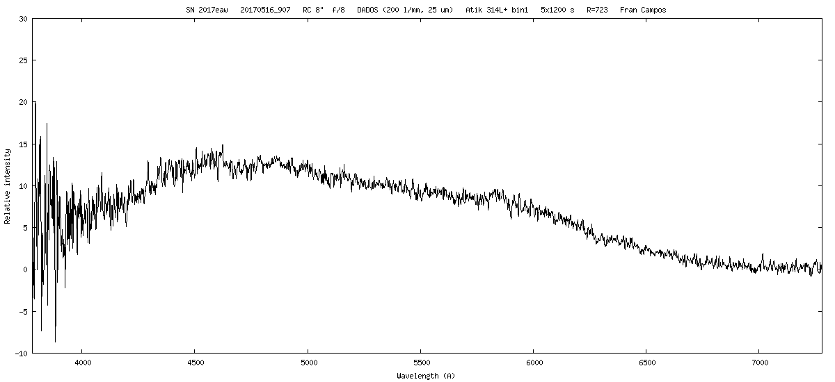

here is the spectrun I could take this last night. As Etienne, I have also noticed the decreasing intensity in blue wavelenghs. Apart from this one, very few details can I see. GELATO also gives me a Type-II supernova, more likely a IIL-type, but the fit strenght is low.
Photometry observers noticed that the supernova is still brightening. I'll wait some days to take another spectrum. It's not easy with my telescope, due to the low S/N relationship and the huge light pollution I "enjoy" in the East sky.

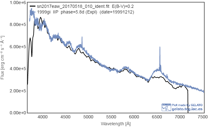

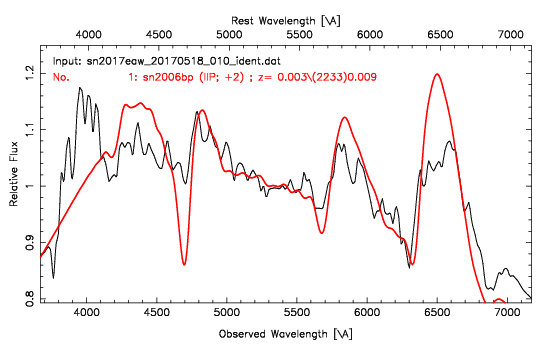

I was able to get just 10min exposure time on this object last night before the clouds arrived. It is a bright target for the modified ALPY 200 though so it was enough to get a good low resolution spectrum.
SNID is confident it is a type IIP near maximum light. Here is the best fit
(It looks like SNID still applies some sort of adjustment to the continuum to match the two spectrum when plotting)
GELATO cannot decide on the sub type but the best fit is a IIP 6 days old
The spectrum has changed significantly around 4500A compared with the BAO spectrum on TNS. The broad line there has gone. This is similar to what was seen in at this time in sn199gi for example
