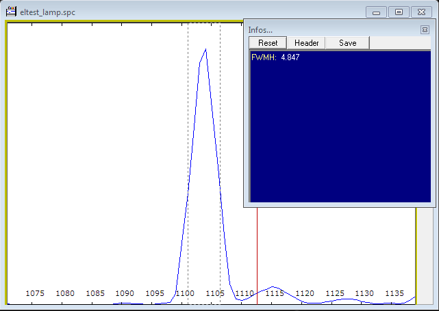

I think it is quite unusual to find the star image significantly smaller than the 23um slit with a 200mm aperture. Your telescope collimation, focus and seeing would need to be very good. (What focal ratio is your telescope?)
I would also recommend re-checking your spectrograph focus. The lamp lines look a bit wide to me (about 18A FWHM instead of the expected ~12A). When the spectrograph is in good focus the FWHM of the lamp lines should be similar to the slit width (23um or ~5pixels for your ATK428)
Here is a lamp line profile (in pixels) for my setup (ALPY600 ATK428 calibration lamp module)

Let's look on the calibration FWHM on my ATIK428EX camera (pixels : 4.54 microns). My resultts are near 5pixels but not as good as your 4.7px.
All processing is generaly done with ISIS but here graphic and FWHM computation are done with Rspec.
Résults :
- at 733px (4764A) : 5.5px FWHM
- at 1172px (5852A) : 5.3px FWHM
- at 1482px (6599A) : 4.9px FWHM
I still have room for improvement to reach your 4.7px result. I understand it may be the cause of such strange pattern.

In a trial to get refernce data that source (oakobsevatory) has been also identified. However the defects I am talking about are very smalls compared to the defintion of that picture. An overall overview of our spectra looks very similar at this scale. Regarding the process to check the Ne/Ar lines you will find above my present result It looks acceptable for my point of view but I may be totaly wrong as we are missing detailed benchmark. Robin had a very usefull input : fwhm goal around 5 pixels for a CCD with 4.54 microns pixels size. In the Hbeta region I am getting an Fwhm of 5.3 and 4.9 arond Halpha (Robin is at 4.7). This 10pct difference may explain that quality defect but I am not sure it is the only cause. Also it should point ot again that we got the same type of defect on 2 very differents telescope : T60 (less visible) and a Newton 200mm, using the same Alpy equipment. It may be a small but complex issue on which I apologise to generate so many exchanges on that forum.
Next step for me will be to improve the Alpy focus to reach Robin's benchmark. Trial will also be done to improve the telescope focusing method. However I am not sure how this will impact the line profile as previous exchanges tend to indicate we are not far for expected level. Here also it is hard to find documented numeric results for reference (expected emission line width or spectrum width for specific setup).

I alm happy to close that subject with an experiment to confirm Robin's assumption : the source of the issue was a slight defocalisation of the Alpy spectrograph, probably during transportation on our way back from Pic de Midi to Toulouse... After focus ajustement the FWHM of calibration line in pixels went down from 5.2 to 4.4 and the small defects on emmision lines has now disappear (see graph below on a zoom to Hbeta - OIII 5007 region). FWHM in angstroms is now at 9.9 for the OIII 4959 line.
