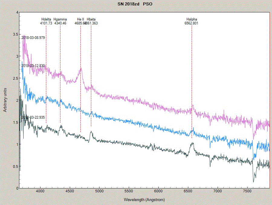

Wow Robin, that SN 2003hy in your adsabs link transformed to a so different shape within 1 month! (but nothing in between)
Also surprising how different days are estimated (-15, -100: ?).
I'm trying to google for an example spectrum serie of type IIn, but can't find any yet.
- Peter

It looks also on your spectrum the Balmer increased earlier than seen for other IIn types. It has motivated me to revisit this object.

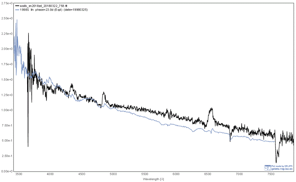

Here is mine from 2018-03-24, as the last in my evolution serie:
2018-03-22: 15 x 1200s, ATIK 414 EXm, Alpy 600, 18u slit, 300/1200 Newton, eq6
Gelato yet reporting unknown type bringing 2009bw IIP on front, but many of type IIn with 1998S as the next - however, Balmer increase looks happening earlier than in case of 1998S:

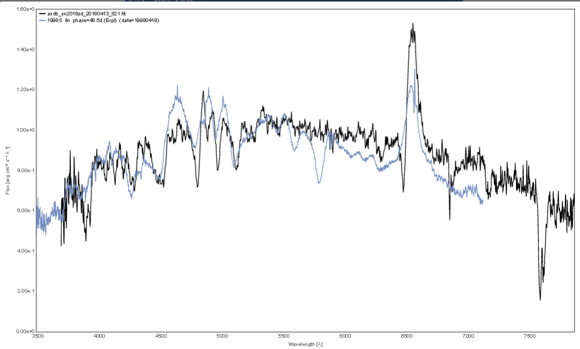

I wanted to have a serie finisher for SN2018zd, last night got the chance:
tons of exposure (13 x 20 minute), suitable for the 14.1 Vmag
It's being stuck at 14.1 mag for a long time.
Gelato suggests "91% type II", with all the mostly offered IIn samples (most of them 1998S) having somewhere different absorptions.
Finally, good to see that it's not a simple repeat of an already categorized type.
- Peter
