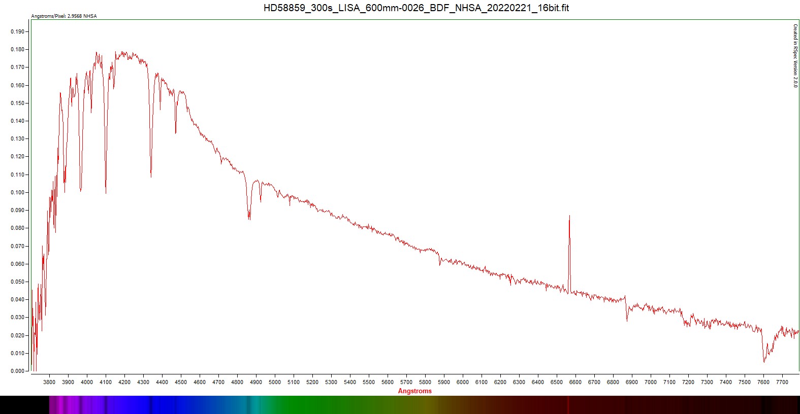

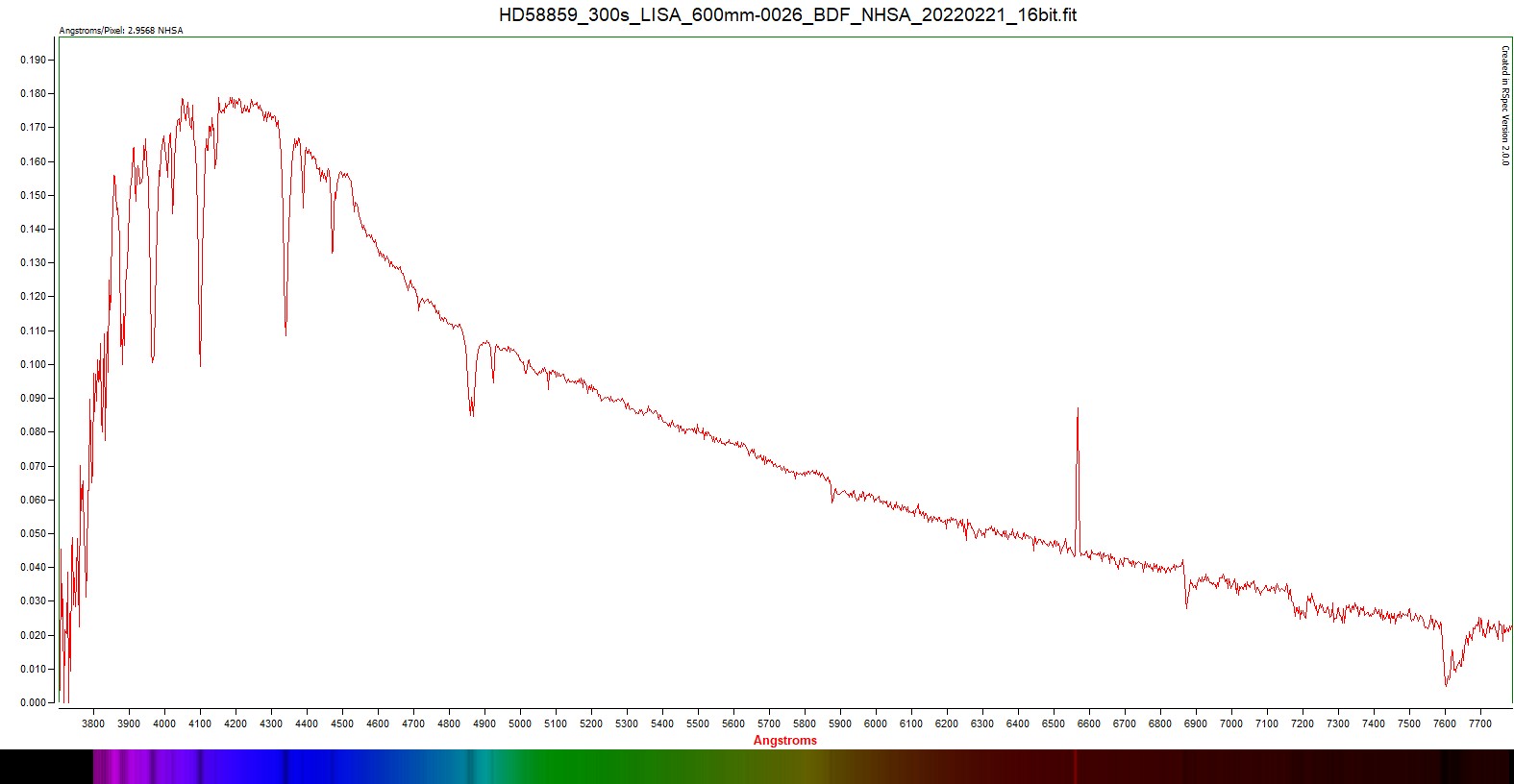

I have been reading this topic and tried my luck at this star at Bortle 6 sky.
Spectrograph LISA @23µm slit on a TOA 130 with 0.6x reducer.
26 images with 300 seconds exposure time, biased, darkened and flattened and instrument response corrected using Menkalinan star.

nice work Rainer! From the picture, it appears that an emission peak in the bottom of the Hbeta absorbtion is just visible. Would you mind forwarding the fits file to me so I can plot a comparison with all the other spectra? I'll send a direct message with my email address.
Hamish
