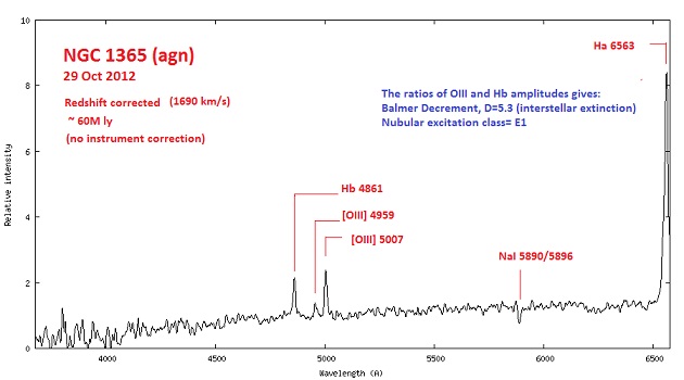

I think it is interesting to examine the 'bonus' spectra of the NGC1365 core, an AGN galaxy with some useful emission lines, around 60M ly distant.
NGC1365 core.jpg (45.03 KiB) Viewed 12311 times
With only the two nebular [OIII] and Hb lines it is possible to determine the galaxy's distance, nebular excitation class and interstellar extinction.
Even though I've been taking spectra for a few years it never ceases to amaze and impress me that spectra from 'simple' backyard equipment can reveal so much about such distant worlds.
Cheers, Bernard

Hi Bernard,
very nice spectrum. Your caption is somewhat ambiguous. On one hand you write that the spectrum is not instrument response corrected, on the other hand you calculate interstellar extinction. As far as I know interstellar extinction is calculated from the Balmer decrement (ratio of H-alpha to H-beta) using an instrument response and atmospheric extinction corrected spectrum. How did you calculate it? I agree with you, an interesting object.
Regards, Martin
Re: Supernova in NGC 1365
Posted: Wed Oct 31, 2012 8:40 pm
by Bernard Heathcote
Hi Martin,
I'm sorry about the confusion. The reason the displayed spectra isn't corrected is that the instrumental response curve I have stops just before Ha and if used then that emission line doesn't appear. I didn't realise this at the time and need to make a new one. To calculate the Balmer Decrement I certainly did make manual corrections for the instrumental response, which is flat in the Ha zone. Atmospheric corrections also applied.
Cheers, Bernard

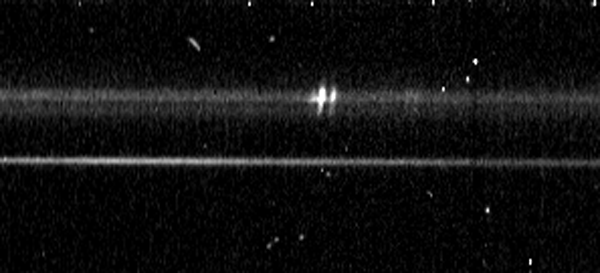

I had better success last night and was able to take about 80 minutes of spectra with my LISA.
A comparison spectra is here
Bernard.
Below is a crop of the region around Ha of the raw spectra of the core of the galaxy. There is certainly some asymmetry. I agree that this is strange as it is a face on galaxy. Any suggestions?
Terry
