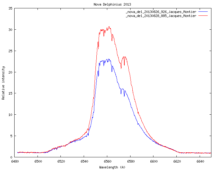

20130828_885 Halpha spectrum with C11 and LhiresIII 2400 t/mm
I confirm the double pic shape on the red part of the alpha line as intensity is still increasing.

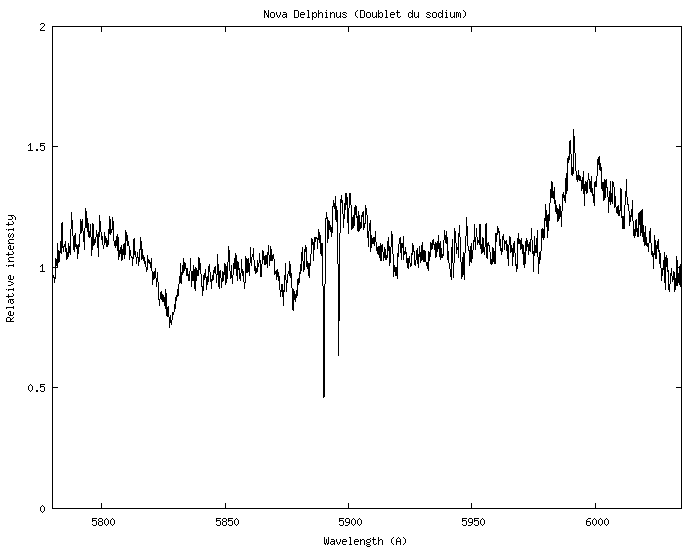

by Jacques Montier
Bonsoir,
20130828_982 spectre de la région du doublet du sodium ; C11 + Lhires 2400

by Olivier GARDE
Evolution of Halpha line and H beta line during last 48 hours.
In blue : August the 26th
In red : August the 28th

Posted: Thu Aug 29, 2013 9:55 pm
by Ernst Pollmann
In order to play further within the concert of these amazing results:
here the (neverending) Halpha growth of this evening.
The "red shoulder" comes more and more significant.
I am curious what the expert´s explanation regarding of this separation of two velocity areas is.
