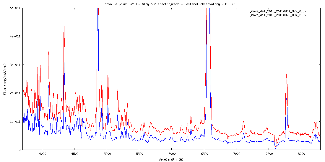

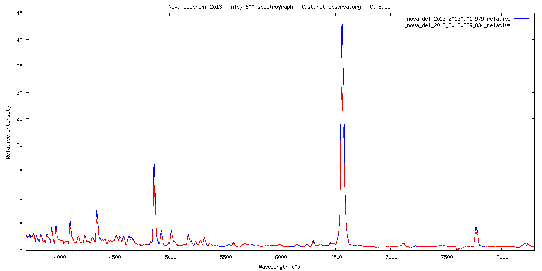

A direct application of flux conversion :
- comparison of Aug. 29.83 and Sept. 1.98 spectra in flux unit (erg/cm2/s/A)
- comparison of Aug. 29.83 and Sept. 1.98 spectra in relative intensity (normalization zone 66650-6680 A)
The magnitude difference between the two date measured from flux spectra is (numerical Bessel filters set):
0.51 in B
0.56 in V
0.45 in R
To be confirmed (new measures this night).

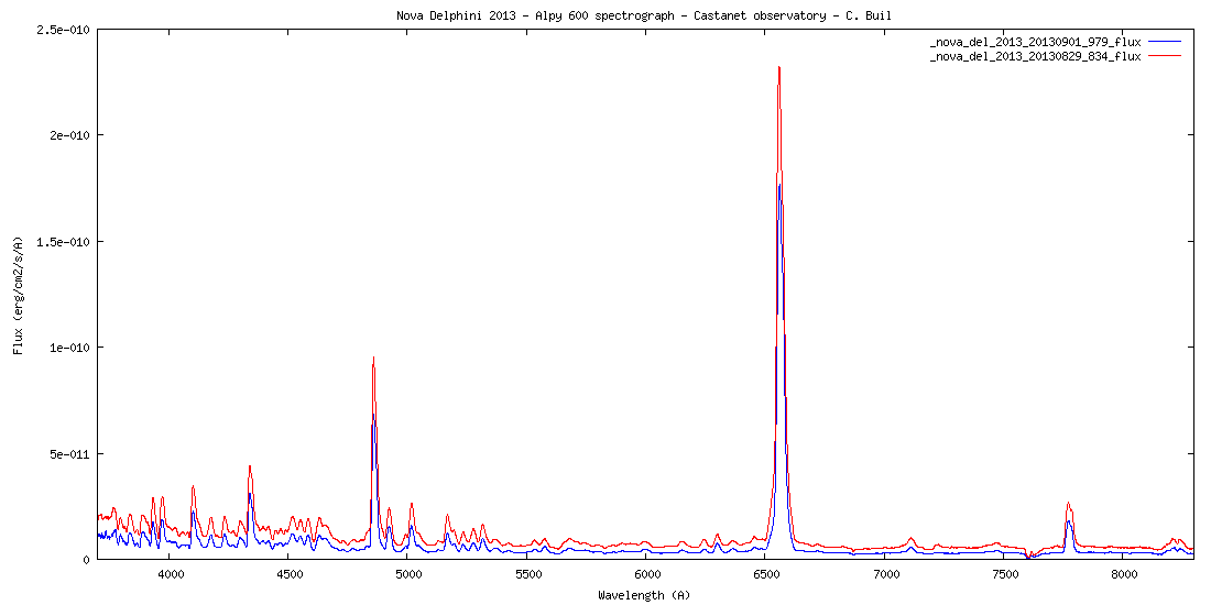

Hello Christian,
The change in calculated V mag in 3 days seems larger than expected compared with the AAVSO data which is showing a slope of about 0.1 mag/day currently
Like Francois, I am also experimenting with flux calibration using V mag values. Is it possible to post the fits files of your flux calibrated spectra?

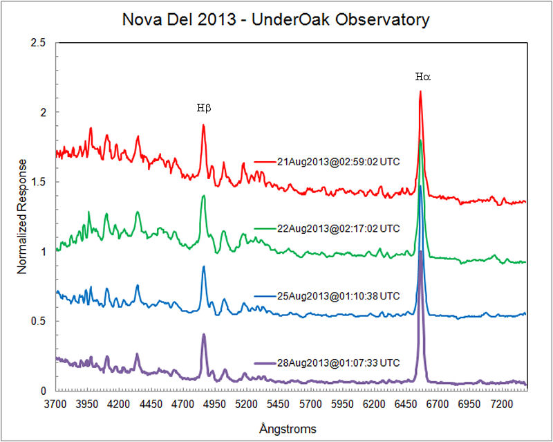

I've been monitoring Nova Del 2013 since 21Aug2013 using a low resolution SBIG DSS-7/ST-402ME spectrophotometer and would like to share some of my results. Typical exposure times on a 20 cm SCT ranged between 40-50 sec using the narrowest slit (50 µm). Data reduction using HD 196544 as a reference was performed using RSpec. BTW, many thanks to Robin for helping me through the process. So far spectra have been generated on four separate days and can be seen below.
Nova Del 2013_Overlays_v2.jpg (93.25 KiB) Viewed 36127 times
Excellent results Kevin.
I wainting for the fit files as soon as you'll have fix the head issues.
Welcom on the forum, the camapaign and spectroscopy world
Best regards

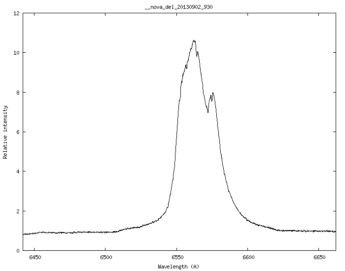

Dans la nuit du 2 au 3 septembre, le spectre au Lhires 2400 de H alpha montre un pic montant péniblement à 11 environ en valeur relative.
Vous confirmez ou c'est une fausse manip de ma part ?
Merci à vous,

Jacques, regarde ta ligne de base (le continuum) : il n'est pas normalisé à 1, et donc
tu ne peux trouver la bonne valeur au pic. Faut commencer par normaliser, puis ensuite
on pourra évaluer.

Christian Buil wrote:Jacques, regarde ta ligne de base (le continuum) : il n'est pas normalisé à 1, et donc
on pourra évaluer.
Si, si Christian, la ligne de base était bien normalisée à 1, mais dans Isis -> Gnuplot, j'avais fait démarrer l'ordonnée Y1 à 0.5 au lieu de 0.
Ça induit en erreur car quelle que soit l'origine des y choisie dans Isis, Gnuplot affiche 0 sur l'axe des y...
C'est corrigé sur le post en mettant cette fois l'origine des Y à 0.
