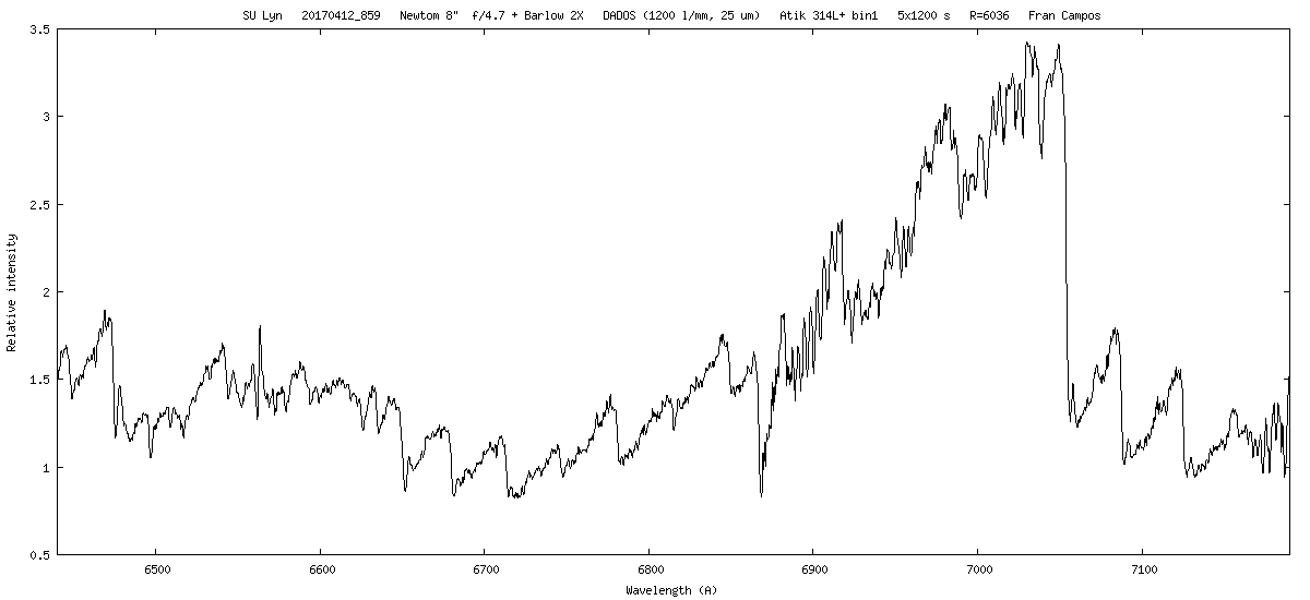

Hi, everybody,
a fresh spectrum of SU Lyn from the last night. I'm doing also some BVR photometry with a cadence of 3-4 nights (one point per night for SU Lyn but also for AG Dra) but I don't know where to send the results. Maybe to the AAVSO database?
Greetings
Fran
Re: SU Lyn Call for observations by Katarzyna Drozd
Posted: Thu Apr 13, 2017 4:50 pm
Hi Fran,
Very interesting spectrum. The range will be perfect for AG Dra and the Raman bands
Yes, I think the best is to send the photometry to AAVSO database
Which star have you used for comparison
Al the best,

Francois Teyssier wrote: Yes, I think the best is to send the photometry to AAVSO database
Hi, François,
I use HD 46608 (000-BBL-578) to do photometry (B:7.461; V:7.391 Rc:7.295). It's a good comparison star but you need a wide field scope to observe both stars. I use a 66/400 mm ED and a ST-8XME with the mandatory BVR Johnson-Cousins filters. At this precise moment I'm doing time-series photometry only in the B band, instead of a single-night point, in order to detect flickering or some kind of fast variations.
For spectroscopy I use 11 Lyn (HIP 31665 = HD 46590; A2 V according to Hipparcos catalogue). It's very near of SU Lyn, so I believe it's a good comparison star.
Greetings
Fran

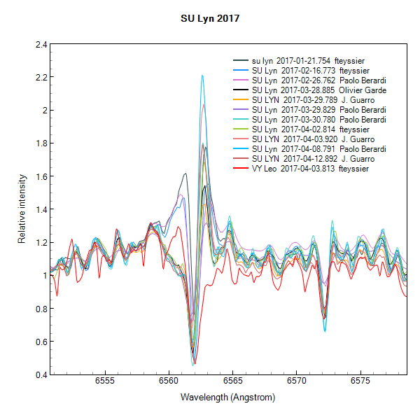

An update of SU Lyn observations at R > 5000
SU Lyn.png (86.35 KiB) Viewed 11162 times
The red spectrum is the standart M5.5 III VY Leo, for comparison
A very nice coverage near the minimum of emission
See EG And in http://www.astronomie-amateur.fr/Docume ... CE2016.pdf
A 2 or 3 years monitoring will alow to determine the orbital elements
I suggest using the heliocentric velocity tool during the treatment.
