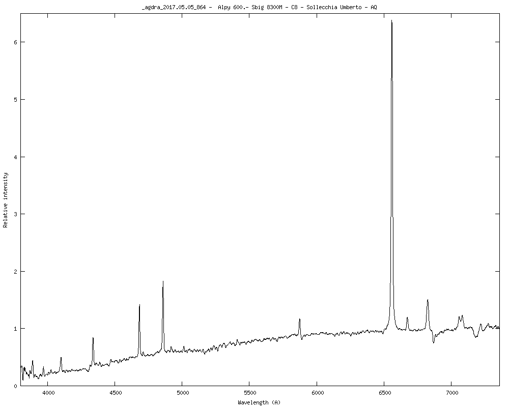

Posted: Sat May 06, 2017 9:08 am
by umberto sollecchia
Bonjour à tous, voici mon observation du jour 05/05/2017.
Profilo AG Dra.png (7.9 KiB) Viewed 10791 times
