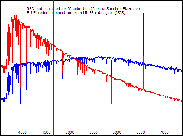

Hello Christian,
There is still a problem. The reddened MILES spectra in ISIS still do not agree with the uncorrected spectra from Patricia Sanchez-Blazquez. You can download them from my dropbox here
https://www.dropbox.com/s/9gqi2e16iphwu ... ar.gz?dl=0
HD223385 is an extreme example but there are differences with other stars too.
Patricia Sanchez-Blazquez has agreed to help resolve this. Can you detail exactly how you made the reddening correction please ?
Also can anyone take a spectrum of HD223385 using a low IS extinction star as a reference please? (it is blocked by a tree for me now) It should be obvious from this which spectrum is correct.

I have checked two of the stars (HD20041 and HD208501) which were identified by Paolo as showing a small difference between the MILES spectra as observed and the reddened spectra from the first version of the ISIS database V8.
http://www.spectro-aras.com/forum/viewt ... =10#p12531
They are now in agreement in the current version of ISIS database V8 (It has the same version number on the website but I am calling it V8a for my records)
The star HD223385 is still significantly different though. I will raise the problem with this star with Patricia Sanchez-Blazquez
