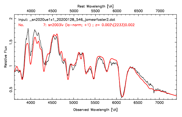

Hi James,
The weather has been terrible here so I have not had the chance to take another spectrum but it looks like we are just past maximum now. SNID shows your spectrum from 28th gives an excellent match to typical Ia at maximum eg

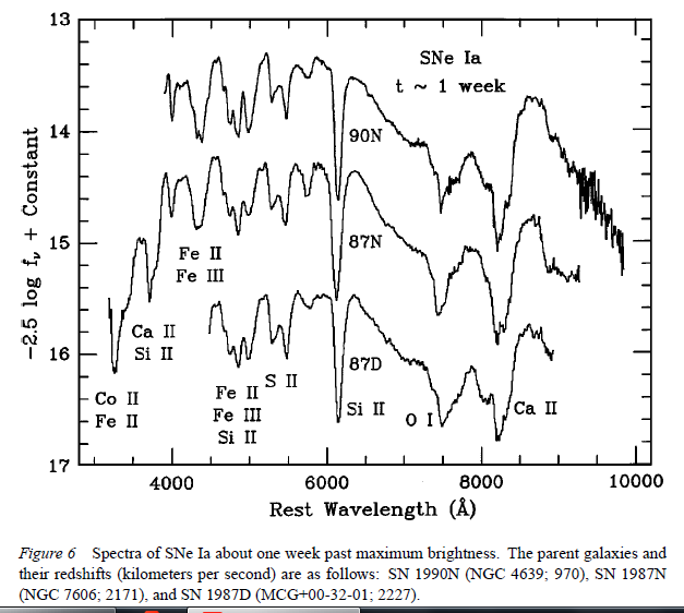

The dip at ~7600 (with the telluric band in the middle) is likely O I and the dip at ~8300 is likely Ca II (both in absorption)
If you want to try identifying the lines (not straightforward because of the blending of the broad lines and the large doppler shifts) the paper "optical_spectra_of_supernovae" by_Filippenko 1997, is a good guide, although perhaps getting a little old now. You can find it here
https://ned.ipac.caltech.edu/level5/Mar ... rames.html
fig 6 is particularly relevant here
Important ! dont forget to remove the galaxy redshift from the spectrum before trying to identify the lines and remember that absorption lines can be significantly blueshifted by the expansion velocity
