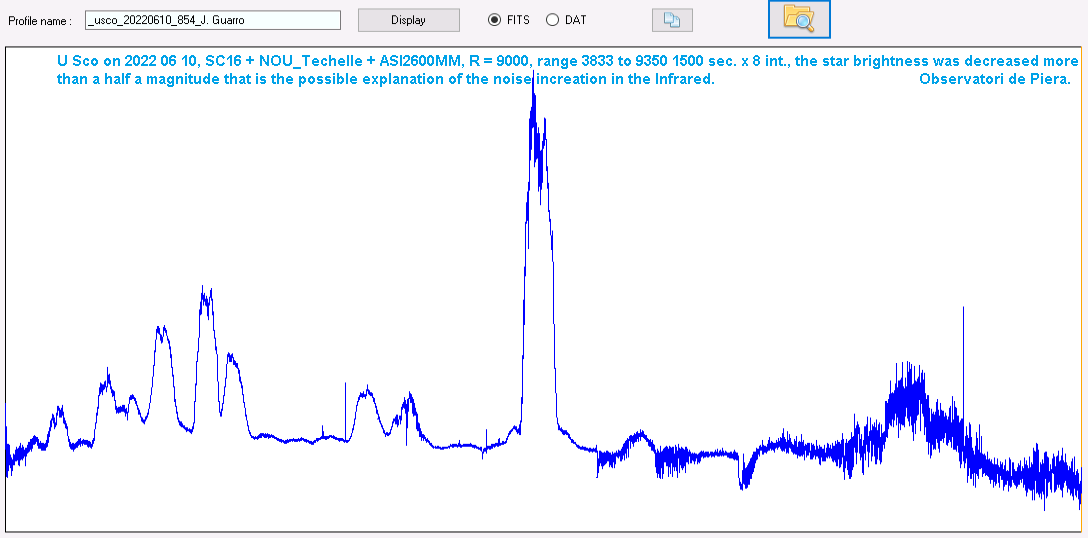

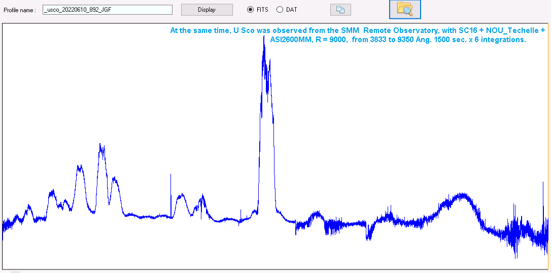

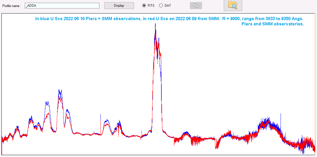

Robin, Umberto and Hamish,
You know that I only take advantage of the thoughts and procedures of other people, my only merit is to spend my time on it.
That is the star last night from the Piera and SMM observatories, I hope that you enjoy these graphics too.
Best wishes for all of you, Joan.

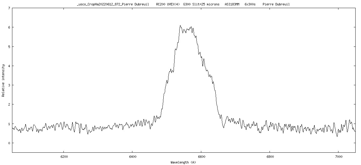

Bonjour
Un peu en retard, U Sco le 12/06/2022 avec UVEX4 G300
Crop sur Ha
Crop sur Ha

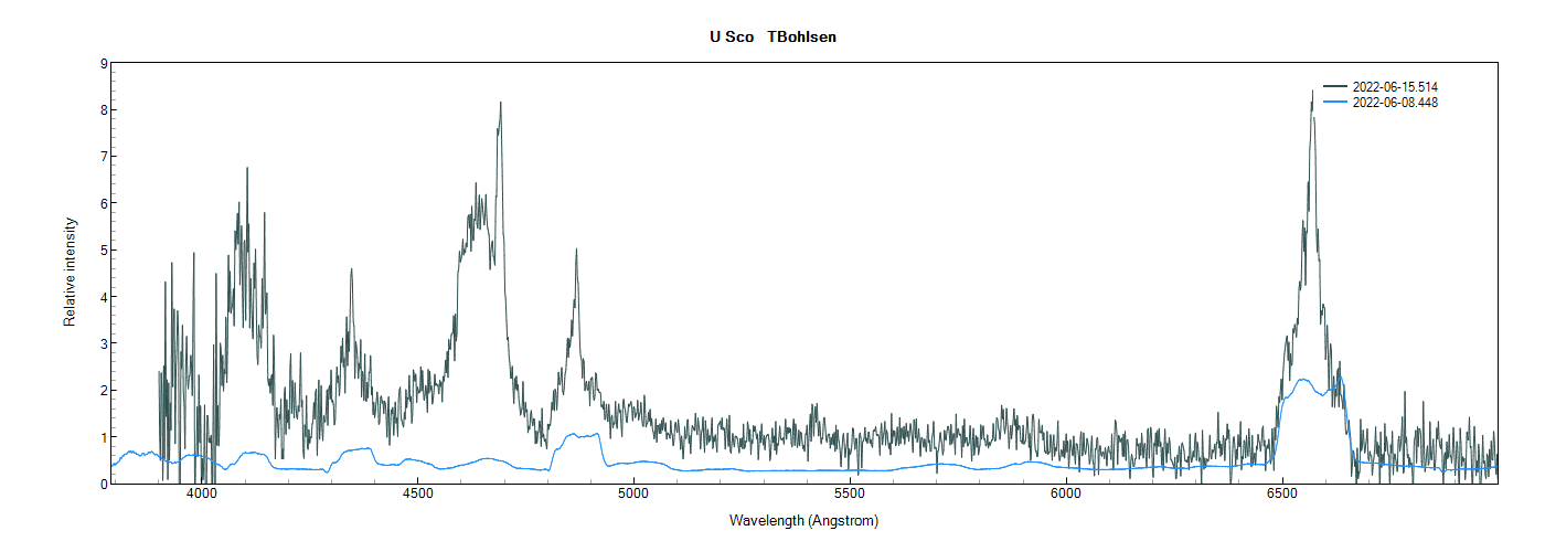

I have taken just 2 spectra of this as the weather hasn't been great. It has dimmed a lot and is now about mag 13. This means the S/N was low for the second spectrum. Taken with my LISA at R=1500
Terry
