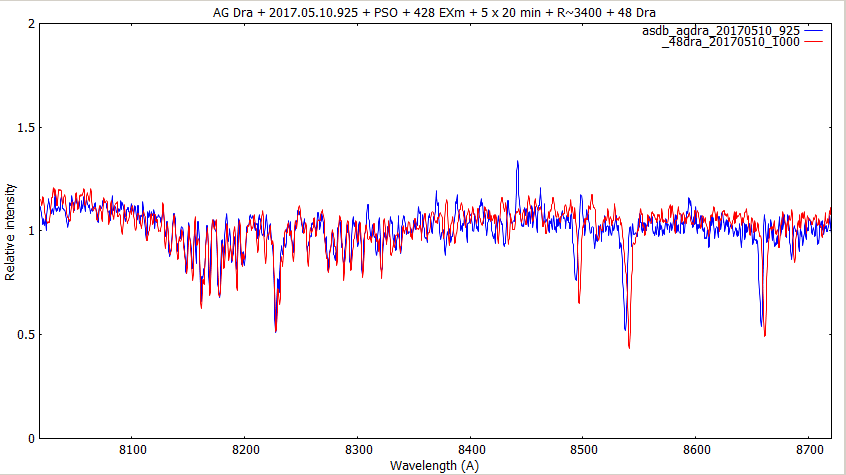

Thanks Paolo for the advices, bought an orange#21 filter (Made in Taiwan - nothing else info just the #21 number - matches the 'Wratten' numbering), basically just confirms your result - no real difference. Of course, did a punch through test at the UV end and found just bias level (without refocusing to UV). It's been put between scope and LHires III (on top of the APM 2.67x barlow) for this time.
Taking a K1 III star '48 Dra', it is possible to speculate what else features may be existing (shifting it by 3.5A some absorptions matching well, including the CaII triplet):
Just the O I 8446 emission line and few little outstanding features are there. The O I 7774 has been left off, maybe trying to fit the next time. Also note the signal is getting halved at the CaII triplet end, according to what the above graph's noise level suggests.

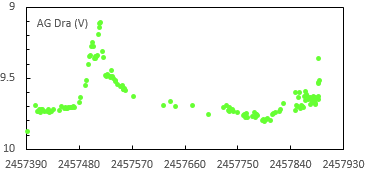

Alert, and confirmation, by Rudolf Galis
according photometric observations (from AAVSO and other observers), AG Dra increased its brightness about 0.3 mag in B filter during last tree nights, what looks like as an expected outburst. It should be confirmed in next night or two, I hope. Rudolf Galis
