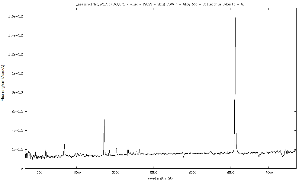

Posted: Sun Jul 09, 2017 5:28 pm
by umberto sollecchia
Bonjour, placé le profil d'observation de la nuit 08/04/2017. Il est calibré en flux absolu avec la photométrie par PaoloBerardi en même temps.Umberto
Profilo nova flux 009-07-2017.png (10.45 KiB) Viewed 93547 times

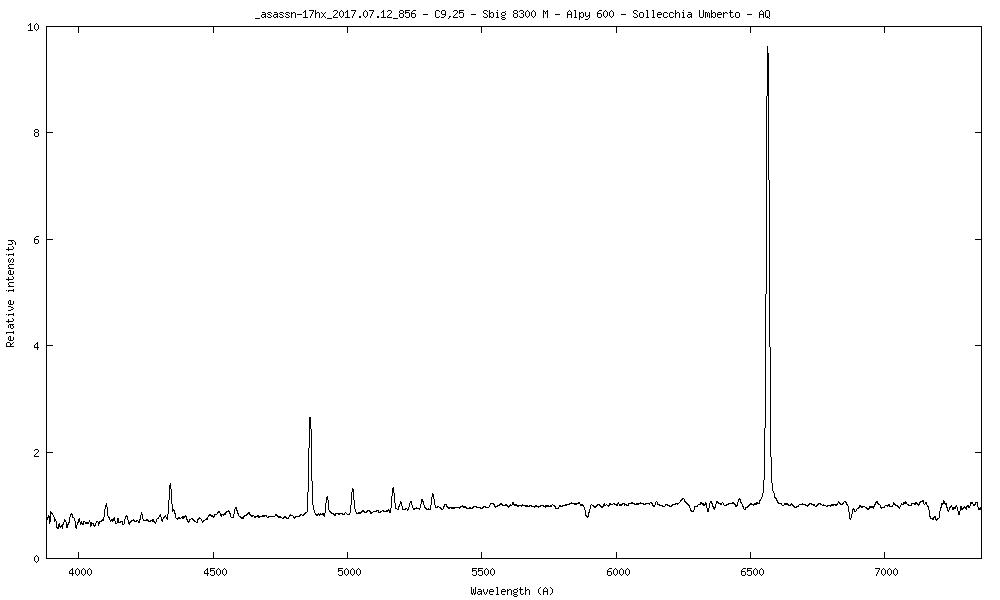

Posted: Tue Jul 11, 2017 2:13 pm
Bonjour à tous, placez le profil d'osservazione della nuit de 10-07-2017.L'étalonnage est flux absolu avec photométrie simultanée de Paolo Berardi.

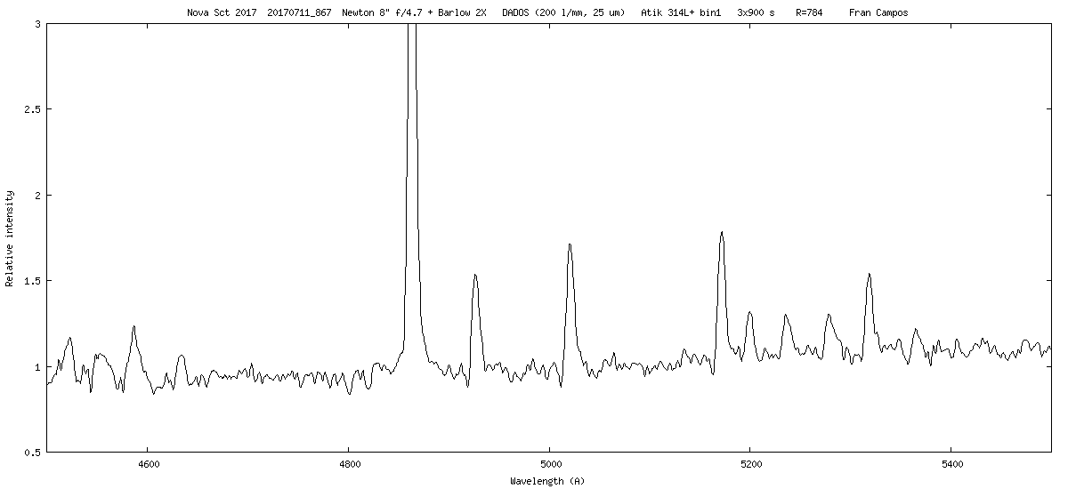

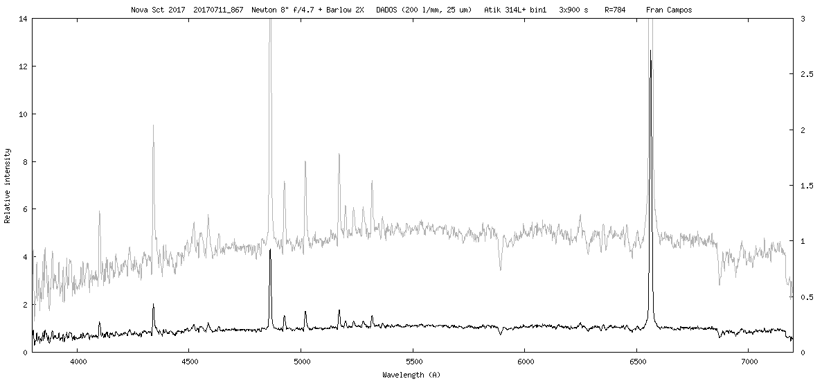

by Francisco Campos
very late, but finally yesterday I could take a spectrum of the nova. Only three shots; these last nights we stand hot temperatures and a very wet ambient, so the sky is often covered by low and persistent clouds. For this spectrum I used HD 179761 as comparison star.

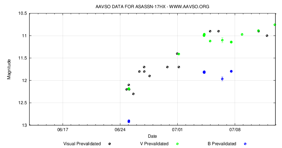

Photometrycally the nova is now at his maximum brightness, according to AAVSO observations. Maybe Nova Sct 2017 is a slow nova (Nb)? Definitively it seems quite different if we compare it with Nova Del 2013.
_novasct2017_20170711_867_FPC amp.png (8.52 KiB) Viewed 93489 times
Greetings
Fran

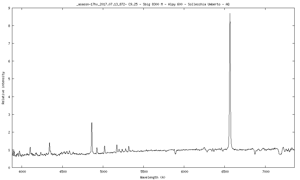

Posted: Fri Jul 14, 2017 6:50 am
Bonjour à tous, placez le profil d'osservazione della nuit de 12-07-2017 et 13-07-2017.L'ampleur de la nova est encore augmentée comme indiqué par la courbe AAVSO.
Umberto.
Profilo nova.png (6.4 KiB) Viewed 93453 times
Profilo Nova.png (6.54 KiB) Viewed 93453 times
