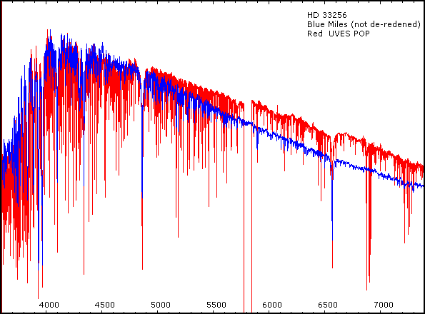

Re: About Miles data base
I had a quick look for any overlap between UVES POP and Miles and found this star. (HD33256 F2v) The continuum is significantly different for the two sources
comparison of miles and uves pop databases
Thank you Robin, you gave us an important information. The use of Miles profiles remain one of the best way to calibrate wide-range spectra. For shared observations I remember was recommended to use (all observers) the same, close to target, reference star (i.e. eta UMa for SN2011fe). Also using Pickles library spectra we can at least to uniform the results.
Generically speaking I thought there was some tolerance for spectral intensity calibration (after all you can still see wavelenght calibrated only profiles) but it is evident that amateur spectroscopy evolves...
