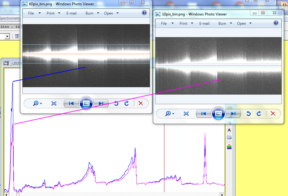

I made a quick comparison with 10 and 60 pixel wide binning zones on my observation 2020-07-13.
The differences are probably small in your graph of sodium intensity but in general the differences can be large (for example the ratio between sodium and CN)
The direction of the slit will also affect the result. (different materials extend by different distances in the tail direction for example)
Your sodium graph is probably ok qualitatively but for quantitative measurements you also have to consider what you are measuring. If you are measuring the emission intensity relative to the dust continuum then if the dust signal decreases (because there is less dust or the distance of the comet from the sun increases) the ratio of sodium to dust signal would increase even if the sodium emission remained the same.
