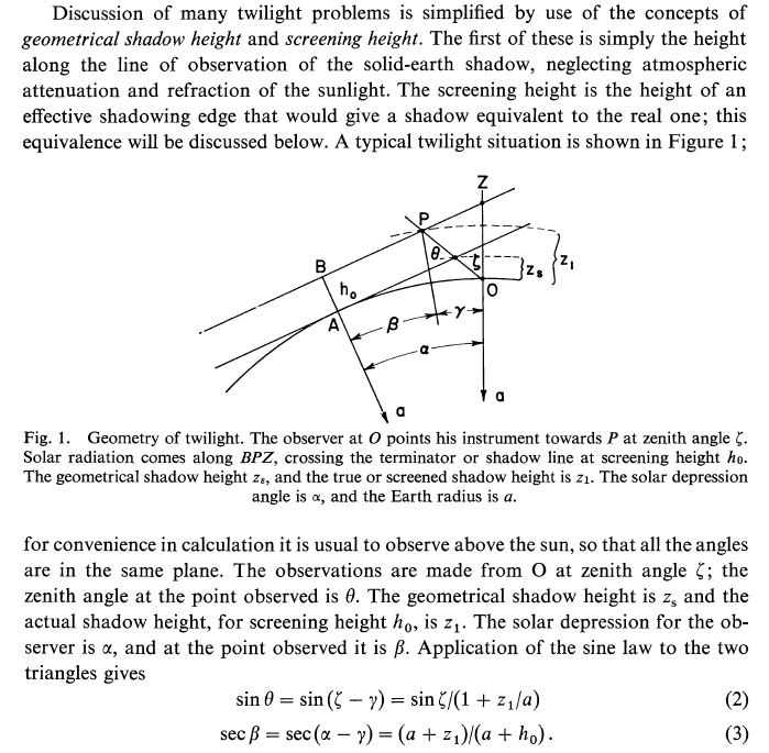

I described previously the terrestric origin of Na-airglow visible in some spectra. In the meantime I also looked at the literature (with the help of Peter Schlatter) and found some supporting literature. Very profound and giving all the relevant details is the following review by D.M. Hunten:
http://adsabs.harvard.edu/abs/1967SSRv....6..493H
From this the geometry of the Na layer illumination can be seen in more detail:
together with some equations for the calculation of the shadow effect. It confirms my basic assumptions. To be more precise I should have talked about resonance scattering instead of fluoroscence.
Much more about the phenomenon can be found in the article. Nowadays the observation of the Na airglow is not so important any more, more precise measurements of the height and density of the layer can be made with LIDAR especially also for the Na layer as a guide star for adaptive optics.
Since the effect varies quite fast during twilight, it is important to subtract the background taken under similar conditions (same sun elevation at the same sky elevation).
Regards, Martin

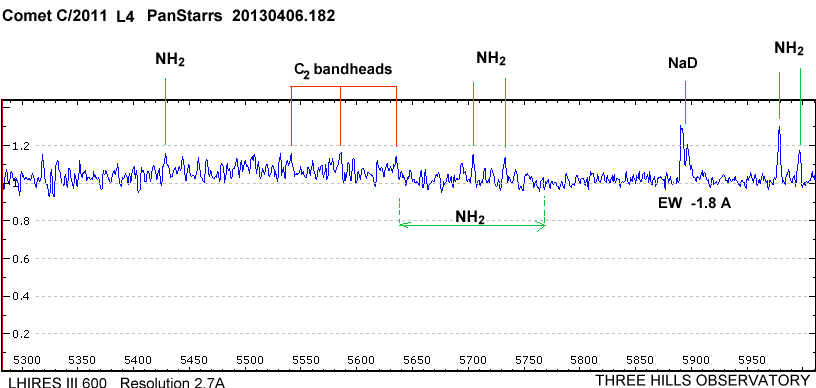

Here is the reduced spectrum. 2.7A resolution, background subtracted, divided by G2v star (15UMa) There is still a small amount of Na D (and NH2, C2) emission detectable in the most condensed part of the comaRobin Leadbeater wrote: I will need to do some careful background subtraction to see if there is still any emission. There is however a pair of clear emission lines about 90A to the red of the Na D lines. More later when I have reduced it.

Excellent Robin! Interesting the NH2 lines presence. Thanks also for the link to lines catalogue (would be useful to create a dat file profile for a more immediate recognition).
Your observation shows a dramatic decrease in comet sodium emission compared to 16 March observation. This confirms Lars remark about emission D1D2 absence in SA100 spectra (now it is probably too weak to appear in such a spectrum). The distance of the comet from the sun is increased from 0.36 to 0.80 AU. Probably the mechanisms underlying sodium emission processes are impacted. I don't know if the comet may have a sodium "emptying" as a result of perihelion passage.

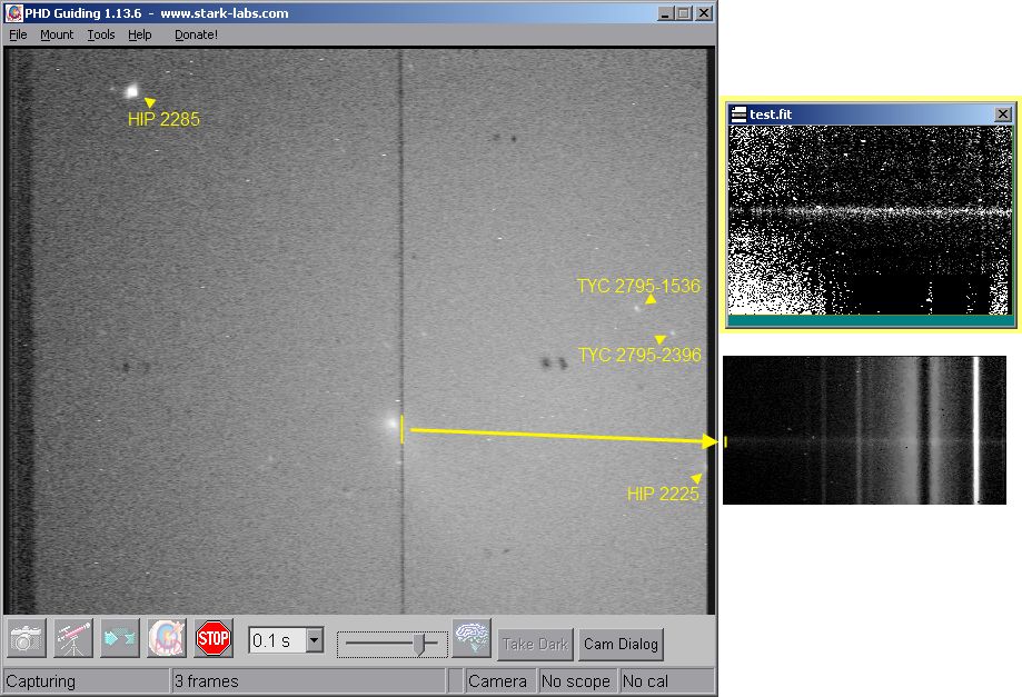

After what has been presented, I feel somewhat ashamed for this post, because it is a very noisy and bad spectrum.. But I tried to go after the tail, and it is difficult.. I also think the resolution I have of the light pollution is very low, so something was likely done wrong.. (collimator focus? Too fast F/6.8 refractor?)
WO-80mm F/6.8 (I know I am wasting light, but I wanted the focal length)
LhiresIII + 300l/mm
KAF-402 binned 3x3 3x300s
slit view + 2D spectrum + sky-subtracted spectrum
LhiresIII + 300l/mm
