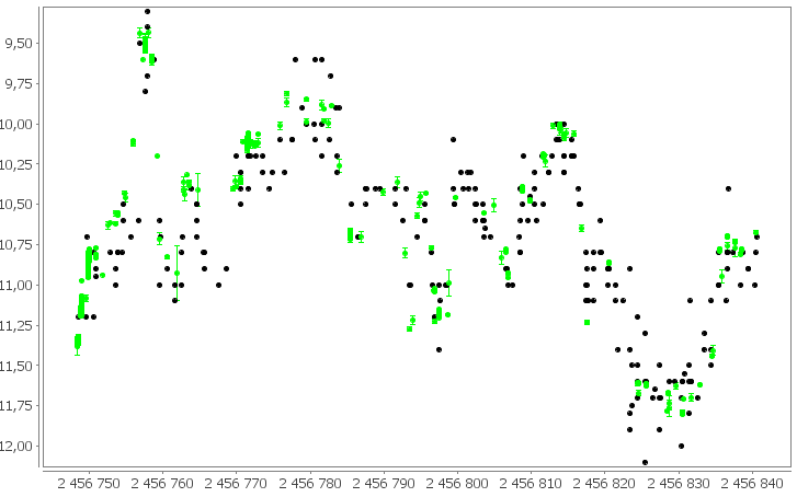

Nova Cyg 2014 : rebrightening Mag V 10.7
Posted: Thu Jul 03, 2014 1:23 am
Tonight spectrum
[OI] 6300 intensity is now near H béta
AAVSO LC
