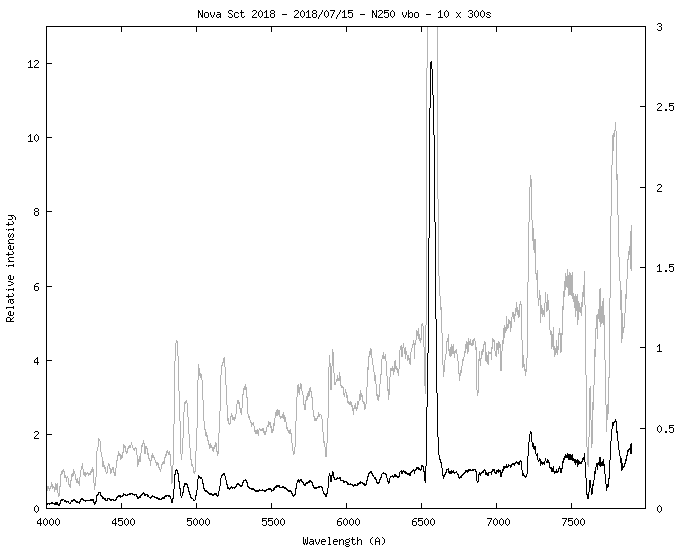

Hello
My little contribution of the Nova Sct monitoring : 10x300s with an Alpy600 spectrograph on Newtonian 250 mm F/4 telescope. I think that the instrumental response and so the continuum is not really good.
The reference star was HD169033 (B5V) to get a nearly similar airmass at the middle of the Nova exposure time. The nova was taken only between 28 and 23 degrees above the horizon ; I've not chosen Gam Sct (A1IV/V) for this reason. I don't know if I've made the right choice.
