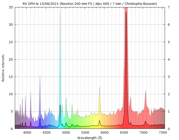

The second one, the 15th of August at 21 h 15 TU (resolution of 535, JJ = 2459442.3853) and an acquisition time of 7 min s (14 x 30 s) :
RS Oph on August 15th, 2021
_rsoph_20210815_885_Christophe Boussin_3700_7565.png (67.19 KiB) Viewed 11636 times

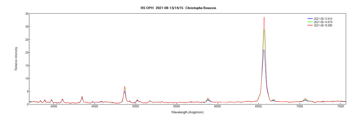

The relative intensities of the Balmer lines have increased significantly as well as those of HeI :
RS Oph on August 13th, 14th and 15th 2021

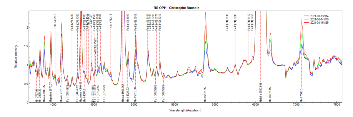

Overall, the relative intensities of the FeII lines seem to have changed very little.
The larger increase in the relative intensity of some FeII lines seems to be due to the presence of HeI lines blended with them (e.g. at 4923 and 5018 A) :
RS Oph on August 13th, 14th and 15th 2021 (identification of some lines from PlotSpectra)

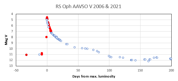

Tout se passe comme prévu
Comparaison des courbes de luminosité des outbursts de 2008 et 2021:
