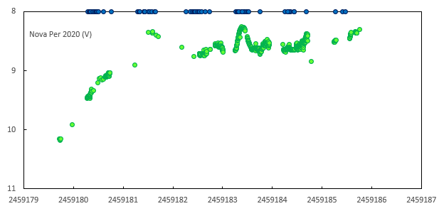

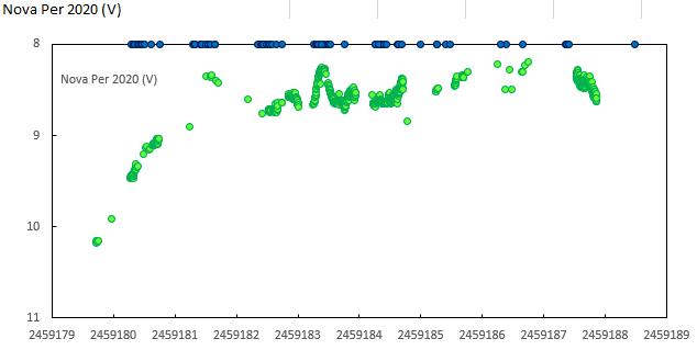

Update of the lightcurve (AAVSO V and ARAS Spectra)
Still at maximum with a trend of brightening.

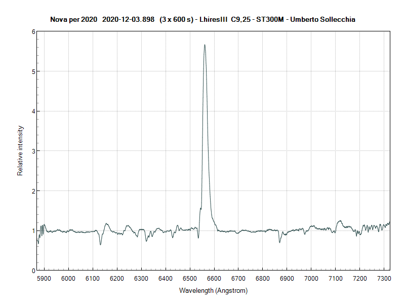

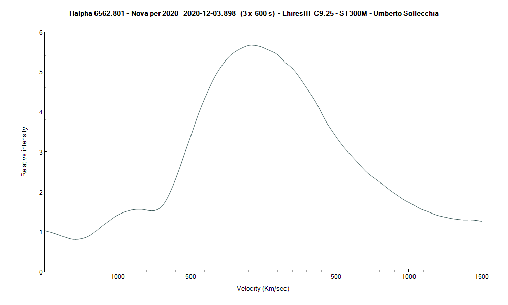

Post by umberto sollecchia »
Une nouvelle contribution de ma part à l'observation de cette nova.
novaper2020_20201203_898_ H-alfa-Umberto Sollecchia.png (28.48 KiB) Viewed 12736 times
novaper2020_20201203_898_VR_Umberto Sollecchia.png (18.53 KiB) Viewed 12736 times

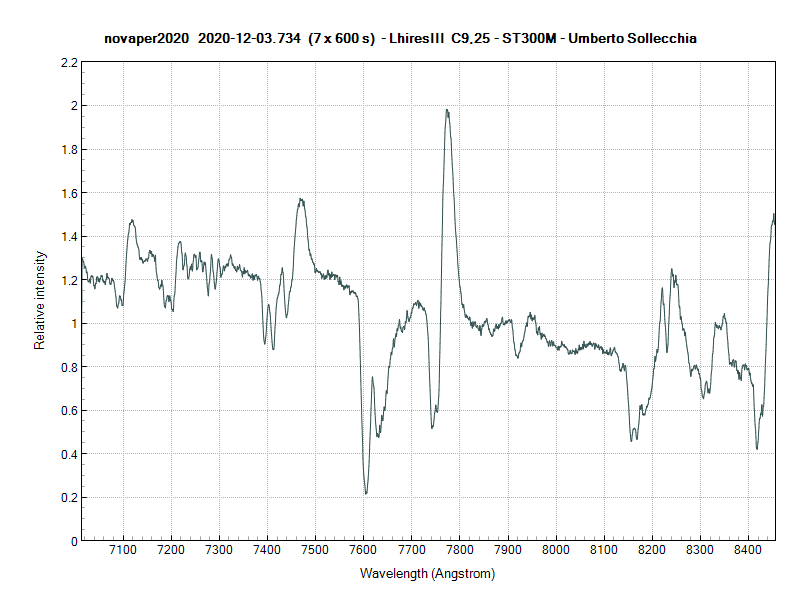

novaper2020_20201203_734_IR-Umberto Sollecchia.png (42.88 KiB) Viewed 12736 times
Hi all, yesterday observation... Near IR field, Lhires III with 600 l/mm grating. Wratten 25 filter to avoid 2nd order contamination.
O I 7773 region
O I 8446 - Ca II IR triplet region (sorry, only one 300 sec frame because of clouds)

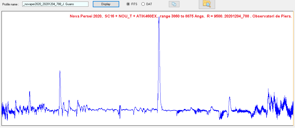

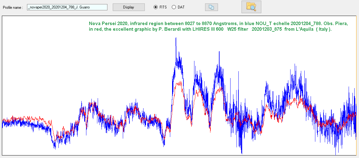

Post by Joan Guarro Flo »
NOVA Per 2020 is following his evolution. I show here the last night graphic and a comparison with P.Berardi results in the infrared.
Regards, J. Guarro.
_NOVA Per20201204.png (21.42 KiB) Viewed 12661 times
_NOVA Per20201204 B.png (48.56 KiB) Viewed 12661 times

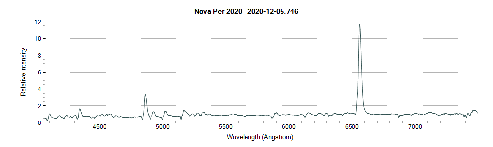

Post by Thibault de France »
today spectra 05/12/2020
Thibault
novaper2020_20201205_746_Thibault de France.png (17.36 KiB) Viewed 12629 times

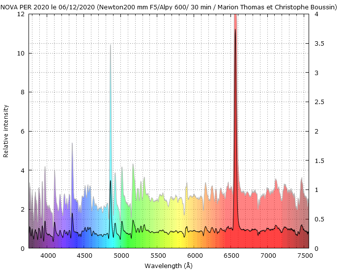

Post by Christophe Boussin »
Here is our update for the Nova Per 2020 with the following spectrum obtained last night the 6th of December at 00 h 16 TU with an Alpy 600 (resolution of 511, JJ = 2459189.5111) and an acquisition time of 30 min :
Nova Per 2020 on December 6th, 2020
_novaper2020_20201206_011_Marion Thomas et Christophe Boussin_3700_7565.png (75.93 KiB) Viewed 12546 times

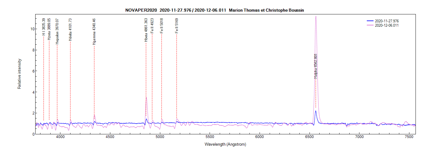

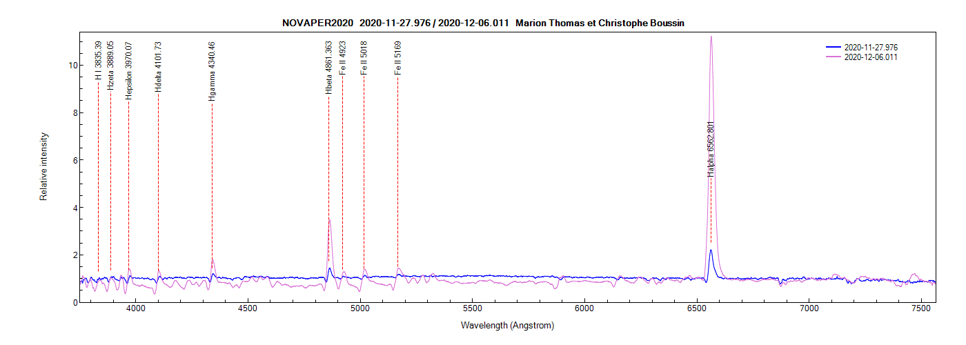

Nova Per 2020 on November 27th and December 6th, 2020 (identification of some lines from PlotSpectra)
We also note a very significant evolution of the spectrum in 8 days. The FeII lines are very clearly visible in our last spectrum and the relative intensity of the Halpha line has increased dramatically !
Clear skies,
Marion THOMAS et Christophe BOUSSIN
