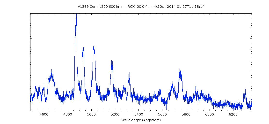

Some belated results from the 27th Jan. Terribly noisy I'm afraid. Still no guiding and I tried to narrow the slit gap slightly which made things worse, plus battling with various other technical issues. Shame as it was an incredible night down here, best we've had in months.
Close up of Hb an the FeII lines.

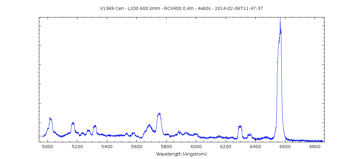

My best result yet, from Feb 6.491. A huge thanks to Andrei Cotiga from Canterbury Astro Society for helping me to get guiding working.
Some structure showing in the H alpha line.

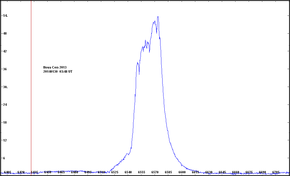

Below is our last profile, made on Jan 30 with a 2400 l/mm grating. I believe the line structures are quite the same perceived on Malc“s spectrum. Also, the trend for brightening, already pointed out by Terry on Jan 28, seems clear.
Last but not least - Jon, many thanks for your comments on the physics of the observed phenomenae. I had read several detailed descriptions about what was happening with Nova Del 2013, but was not able to find many on V1369 Cen. I would be particularly interested on a comparison of the evolution of both novae...any hint on that would be very welcome !
Tasso.
