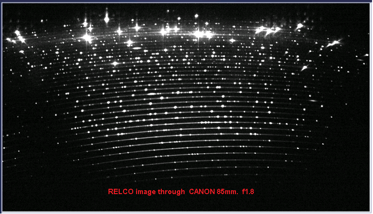

Following in C.Buil's footsteps, these cloudy days I've rehearsed the properties of an old second hand Nikon 135mm. F2.8 objective in my Piera observatory NOU_T echelle.
The Nikon 135mm. F2.8 has 5 optical elements so is simple and it weighs 435grams, only 35grams more than the Nikon 85mm. F1.8 that I used actually.
At the moment the tests and theoretical results are satisfactory, and the RELCO light map
is focused much more better than the Nikon 85mm. one that needs a balanced focus Orders commitment.
Nikon 135mm. F2.8 pros and cons,
More and average order resolution R=10500 in contrast to R = 8500.
Very weight Fits files, 101925KB with the ASI2600MM.
More longer integration times due a more long focal point, but I can't precise
why because it has better focusing.
On the other hand, theoretically Nikkor 85mm. F1.8 is faster than the 135mm. F2.8 and with sufficient resolution for the analysts work studies, so I don't know if it is worth keeping this last one that needs to spend more time and gets minus stellar magnitude.
You can see this test daylight graphic made on the desk and its R values and download some integration Fits from,
https://drive.google.com/file/d/1ReQTHG ... sp=sharing
Cheers, J.Guarro.

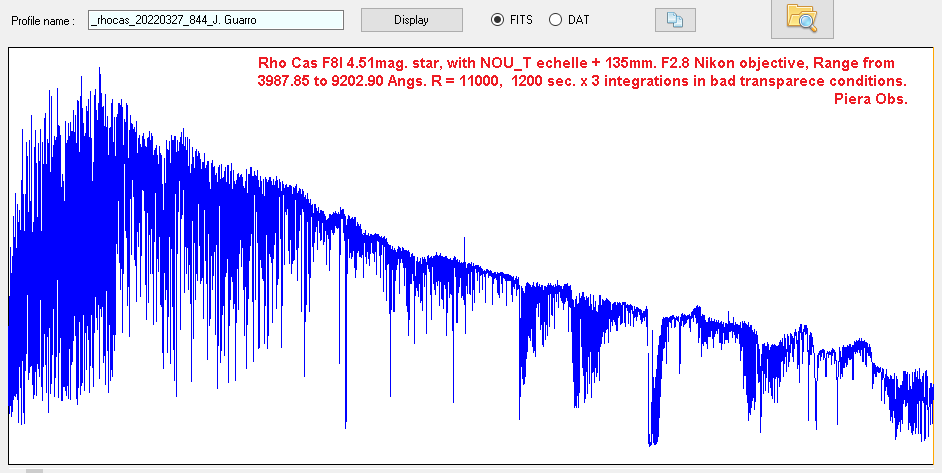

- Posts: 731
I show here three results of the NOU_T mounted with a Nikon 135mm. F2.8 objective, the resolution has increased over 11000 and its dynamic range hasn't diminished.
From this experience I have believed learning two main things, one is that the Nikon at F2.8 has a too small exit pupil and it has some difficulties, so in this case it is better to use a Nikon 135mm. F2.
Second and more importantly, the integration times are increased x 2.5 / 3, and it negatively affects its magnitude detectivity, it want to say a very great loss of operational and observational activity that I don't want to assume.
So if I consider the Nikon 85mm. F1.8 Resolution = 9000 fits well into the standards that analysts need for their study spectra as has been shown in recent times, I'm going to mount this one objective in the Piera NOU_T echelle.
In conclusion, from my point of view, it is necessary to keep a balance with your telescope, your spectrograph and your goals.
Regards, J.Guarro.

- Posts: 458
Nice work Joan! Is there any reason you chose not to use the faster Canon 135 F/2 lens? Not that Nikon is bad, but I think
Christian fully vetted the Cannon for good UV penetration with the ehel.
Also, are you using a optical fiber in your latest data? I like the transmission you get with "direct-camera" on the focal plane, but the light loss
from using fiber is formidable, however your RV's are more stable without a large camera flexing on the telescope.
It would be great If I can get to >9900A with eshel, but the Thor-Argon lamps inside the ehel calibration box barely show any emission lines
