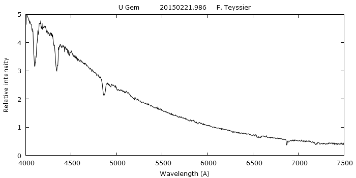

Posted: Sun Feb 22, 2015 1:31 am
Tonight spectrum
Broad absorptions for H beta and H gamma

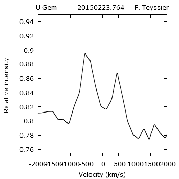

U Gem is now at its maximum luminosity
The spectrum looks flat at a first on raw images, but ...
clearly the double peak of the disk in rotation
and a crop on Ha
with v.sin i ~ 1000 km/s
The disk turns fast !

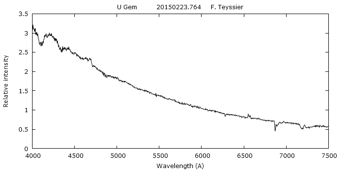

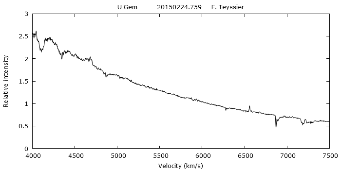

Re: U Gem in outburst
Posted: Wed Feb 25, 2015 6:50 pm
Spectre du 24-02
Begening of the decline
Note the complexe shape of Balmer lines
The V/R ration of H alpha has changed, in comparison to the previous spectrum (rotation of the disk)
A series of several hours should show the V/R evolution ... (for the next outburst)

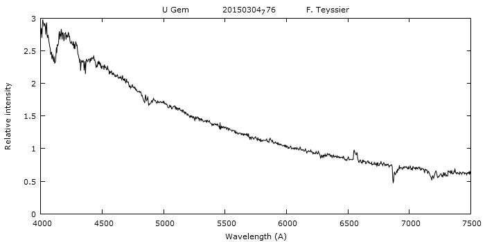

Posted: Thu Mar 05, 2015 5:26 pm
During the decline
Noisy, but interesting shape pf H alpha and H beta

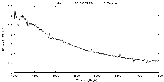

Posted: Thu Mar 05, 2015 8:38 pm
Tonight spectrum

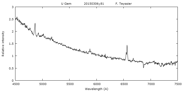

Posted: Fri Mar 06, 2015 9:19 pm
Nive emission from the disk
See also He I (5876 and 6678)

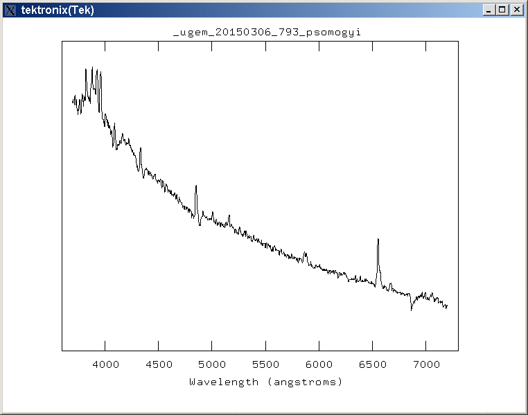

Posted: Mon Mar 09, 2015 9:33 pm
by Peter Somogyi
Nearly started before Francois's last spectra, a 5 hours exposure (with some technical breaks):
Animated gif of every 2 x 20 minute exposures - except last that was 3 x 20 min:
Ref. star was: 79-Gem, taken only 4 times (using averages in between).
Interesting to see the continuum temporary rise while Balmer remains almost there, showing other features.
