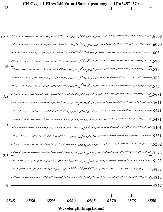

Done:
(diff was made in ISIS, copy/pasted from the graph using same gnuplot params)
Difference to the 1st exposure (every 10 minute, taken a ref.star after only the 3rd shot), generated in IRAF:
You can use the absolute Y scale to see the amount of variations (same scale applies to the normal spectrum).
JD increases from bottom to top (JD fraction as label).
I've taken flat and calibration frames before / after the series, then linearily interpolated between them.
Did not see any move visually, calibration lines were overlapping.
Not much change, this was also my 1st try of the 15um slit. Interesting that I could achieve only R~20000 (not only for this object), or I might need a better focusing method.

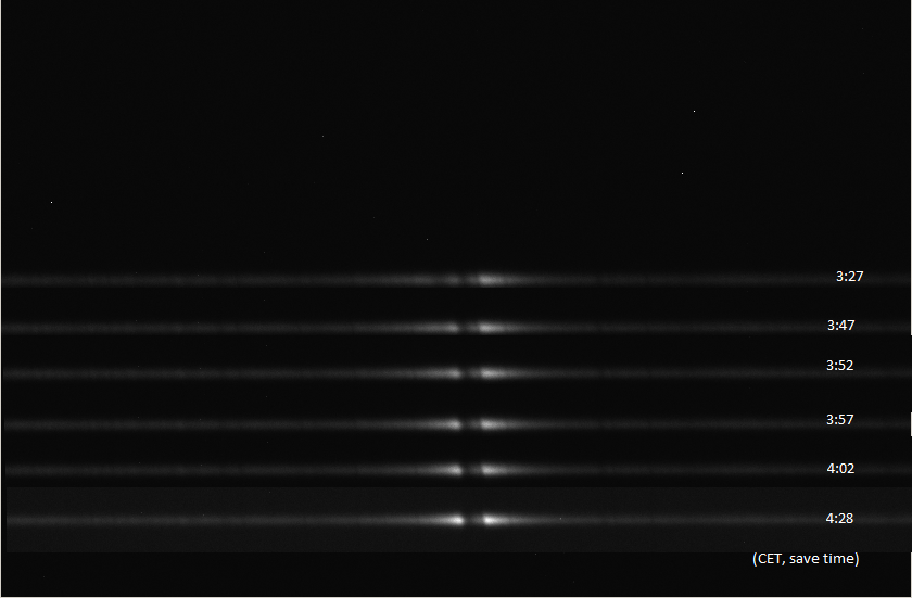

by Peter Somogyi
Caught it (durig sunrise):
LHiresIII + 2400/mm + 23um slit, 5 minute exposures (save time):
(will process it later)
Weather window closed here, somebody should continue in the next 1-2 days.
