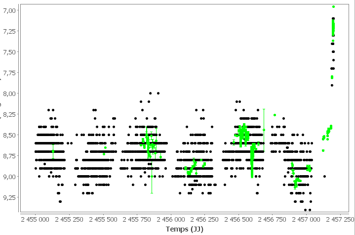

The symbiotic star AG Peg is in outburst.
A exceptionnal event.

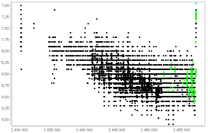

AG Peg had undergone a very slow nova event in the middle of the XIXth century, raising to its maximum luminosity from ~ 1850 to ~1870.
Then it declined ; the decline during more than a century ; it recovered its quiescent luminosity at the begening of the XXIth century.
The AAVSO curve of luminosity (since 1941)
Crop :
The current increase in luminosity is unique in the story of the star !

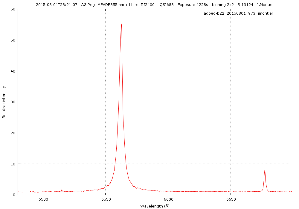

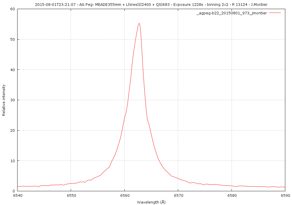

AG Peg spectrum on 2015/08/01 with Lhires III 2400 t/mm
Regards
