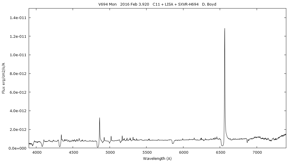

by David Boyd
Here is a spectrum of V694 Mon taken last night 3rd February starting at 22.00 UT. Its magnitude measured simultaneously with the spectrum and used to flux calibrate was V=9.12, almost 0.4 mag brighter than 2 weeks ago. There are strong P-Cygni profiles on all Balmer lines reaching a blue-ward extent on H-alpha of ~2500 km/s relative to the peak of emission. Spectrum sent to the database.

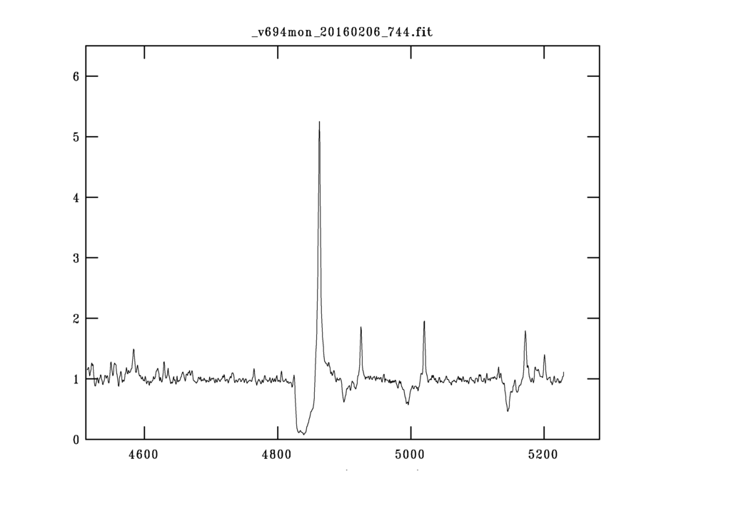

I was shooting it with Paolo in parallel on Feb-6 night at H-beta with 600/mm grating + 35um slit (somehow my coverage is also similar), but I was hunting for short-term changes, with per-exposure calibration before/after (using 2 ref. stars). First 2 x 20 minute were continuous, then the next 3 ones was 1 x 20 minute per each (shooting other targets in between), normalized for 4600-4800A:
It tells H-beta was definitely increasing, and maybe some other lines suspected for variation.
The velocities did not seem to change at this resolution, remained very much the same as Paolo published at H-beta.
Happy hunting!

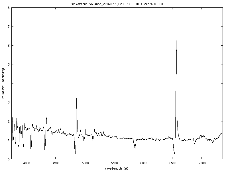

by umberto sollecchia
Bonjour à tous, placez le profil d'observation de 11/02/2016.
profilo v694mon.png (6.08 KiB) Viewed 22571 times
Cordialement Umberto

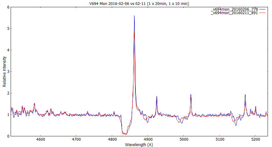

Quick result from yesterday:
LHires III/600/35um/ATIK 414/25cm
All the 3 calibrations (ref.star/ArNe/flat) taken twice before and after again.
It is interesting that H-beta absorption had almost unchanged, while the multiplet to the right seemingly broadened by their absorb feature (look at the 3 peaks to the right)!
Does anybody know the name of that multplet?
