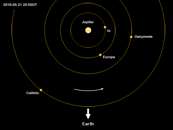

I realize that these can be measures over the limit of the equipment and techniques used. To check again the method and associated errors, on 21 May (bad weather meanwhile…) I observed again the Jupiter system, this time adding the other Galilean satellites.
The scenario during the observing session:
Time table and results of observations:
Error magnitude (in red) respect to SSD ephemeris seem to me not large again, considering the spectra resolution and the relative small spectral range used for the correlation. Much better results should come out from echelle spectrographs (see the tau Boo exoplanet observation by Christian for example).
