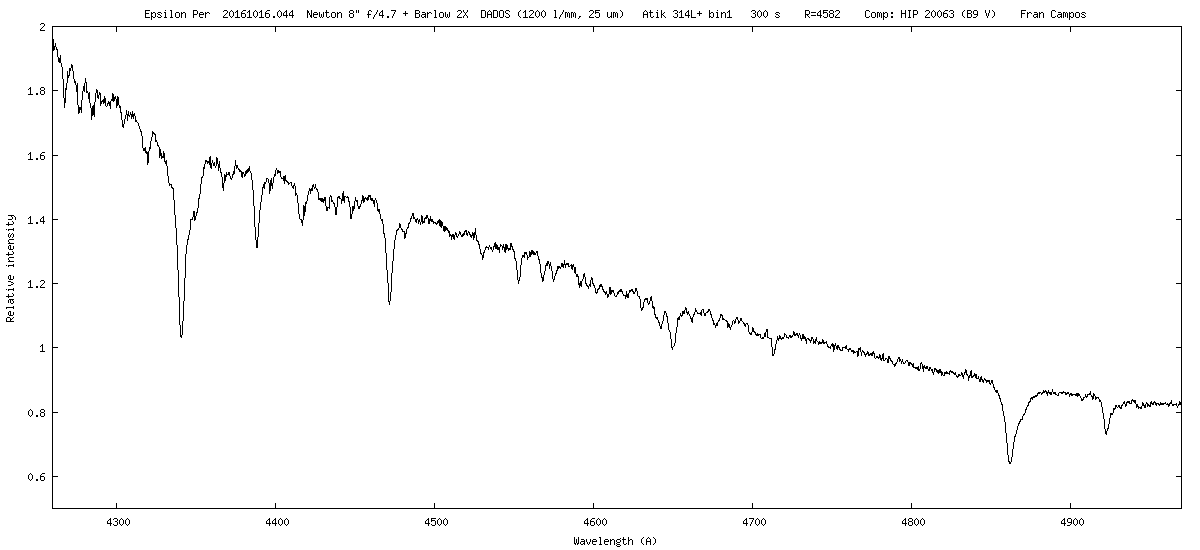

some days ago I noticed about a new project from the BRITE -Constellation network. The goal is to obtain time-series (resolution better than 15 min) spectroscopy of epsilon Persei, in order to obtain data about the pulsations of this beta-Cep star.
I don't have more details about this campaign but I tried to obtain some spectra of this star with the DADOS working close to R=5000. With this set-up, I centered the observations in the H-beta and H-gamma bands. Anyone is currently observing this star or has more information about this campaign?
Greetings!
Fran

I have recently exchanged a couple emails with Gerald Handler who, along with Elzbieta Zoclonska, is gathering data for this object and he says the best region to concentrate on are the Si III lines at 4553, 4568, and 4575 Angstroms. Emails are:
