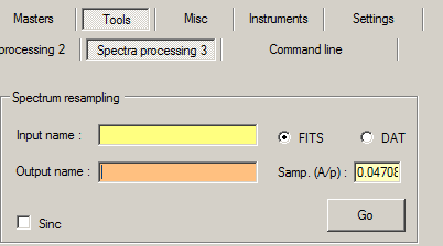

Hi Robin,
"Does anyone know how to generate files (fits or dat) with equal bin width from the UVES POP spectra ?"
I've already tried this feature in ISIS on .fit files with success:
"A/p" is matching with 'CRDELT1' value in the fits header. (However, never tried with .dat format.)
HTH
Re: strange ISIS fault - displaying UVES Castor spectrum
Posted: Tue Jan 10, 2017 11:58 pm
That works, thanks Peter !
That tool can convert a dat file with unequal bin sizes to an equal bin size fits file. That can then be converted to a dat file using the tool in the same ISIS window
Thanks again!
