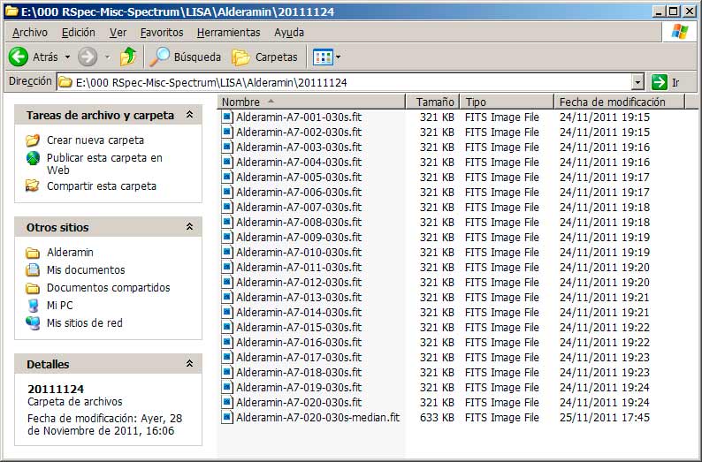

Another point is if I want to process several files the expected numbering system by ISIS is not acceptable for me. It would be by far better to be able to choose several files like it is possible in Windows.
I make all my imaging of spectra in MaxImDL and the file numbering system is different. The file number is not at the exact end of the file name before the dot. The sequential number of my images is before the time which is automatically added by MaxImDL.
Look at the attached image
I thought I just let you know my problems with startting up in ISIS.

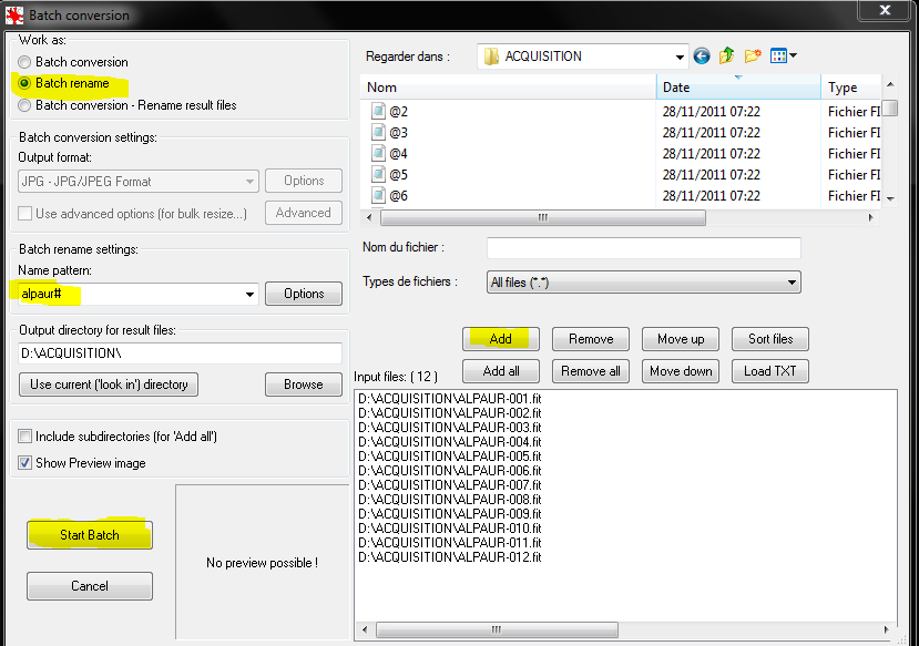

About the MaximDL name format I use the following method :
Batch rename in Infranview
IfranView is a free software : http://www.irfanview.com/
In the File Menu, you choose "Batch conversion/rename"
You get the following window :
Choose Batch Rename option
Add the files to rename
Name pattern : enter the name of the outfile followed by #
The "Start Batch"
Very esay and quickly.
Best regards
