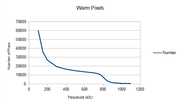

Given the systems efficiency initiative I was prompted to look at to look again at the possibility of using the mean bias level, rather than the bias frame for subtracting from the Darks , Target frames etc. For a CCD this should be a constant (not for CMOS). Obviously you need to look for structure across the bias frame etc...
However, I came across a different issue. I use IRAF and remove the hot pixels using "fixpix" I had set this up carefully looking at the processed images and manually adding hot pixels.
When I looked at the Dark - mean (of bias) I observed a faint snow of warm pixels. Using ISIS to get the data I plotted the number against the threshold see attached. There is a clear knee in the graph with about 10000 warm pixels.
The camera is an SXVR-H694 at -10 C I will look at deeper cooling and removing the warm pixels.
Regards Andrew

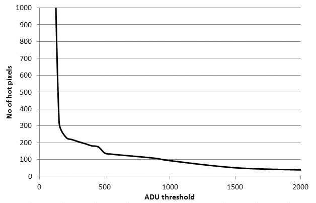

I also have an SXVR-H694 so was curious to see what I would get from a similar exercise. I used my current 300 sec dark frame generated using the normal ISIS protocol. The calibration frames had been collected with the camera cooled to -20C. I plotted up the number of hot pixels eliminated as I varied the threshold parameter in the ISIS Masters tab. There is a similar knee although not so dramatic. Looking at a histogram of number of pixels vs pixel value in the dark frame using AIP4WIN, this is due to a small excess of hot pixels around 490 ADU. Once these have been eliminated the graph jumps down to a lower level. Comparing our results shows the dramatic difference that cooling to a lower temperature makes to the ADU level of hot pixels.
Regards, David

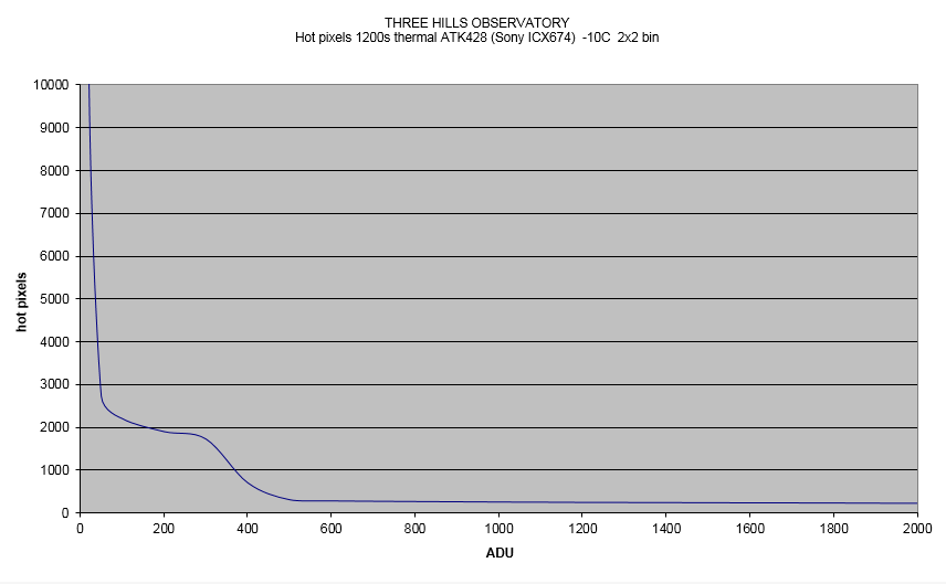

Not directly comparable quantitatively
1200s thermal (median dark frame - median bias frame) ATIK ATK428 (ICX674) 2x2 bin -10 deg C
but it does show the knee clearly so confirms a likely sensor effect rather than something camera specific.
I have had the feeling for some time as I have upgraded through cameras using newer Sony CCD (ICX424, ICX415, ICX285, ICX674) that although the measured thermal noise remains low, the "snow" from warm pixels has been increasing, though I have not quantified it.

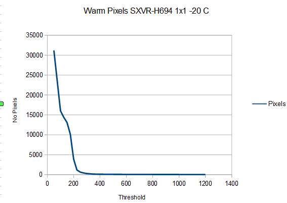

I have now done some flats at -20 bin 1x1 Exp 600s processing them as before the ADU threshold is low as you would expect but the knee is at a similar pixel number ~ 10,000. Looking at Robin's and Davids data it looks like different chips have different numbers of warm Pixels.
My original darks were exposed for 900s not 600 as I stated before.
Not sure if they matter or not Robin it will be a real effort to see if they are linear.
Regards Andrew
