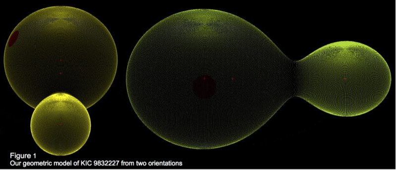

Model of KIC 9832227 - Orbital period ~ 11 hours, declining

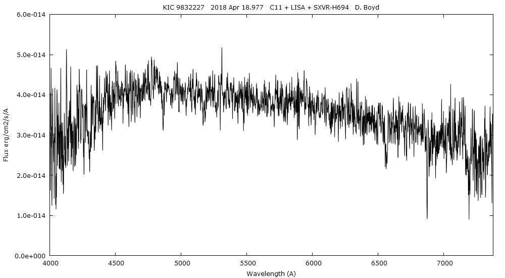

by David Boyd
I recorded photometry and a low resolution spectrum of this object on 18 April 2018. Magnitudes were B=13.17 and V=12.46. The spectrum is noisy but its general profile is in good agreement with spectral type G5V. VSX lists the spectral type as G5 and gives Frasca et al. Astronomy & Astrophysics, 594, A39 (2016) as source. The information is in the online version of their Table A.3.

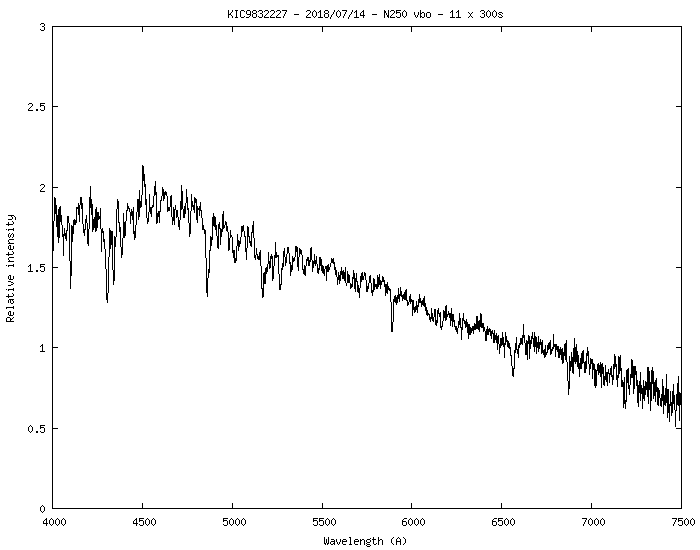

Hello
A low resolution spectrum of KIC 9832227 taken at OHP workshop.
20 x 300s with Alpy600 spectrograph on 250 mm F/4 Newtonian telescope. Really faint target (mag. 12.4).
The choice of the reference star was hazardous : HD200120 (B1.5Vnne)... So, the continuum is uncertain.
Vincent
