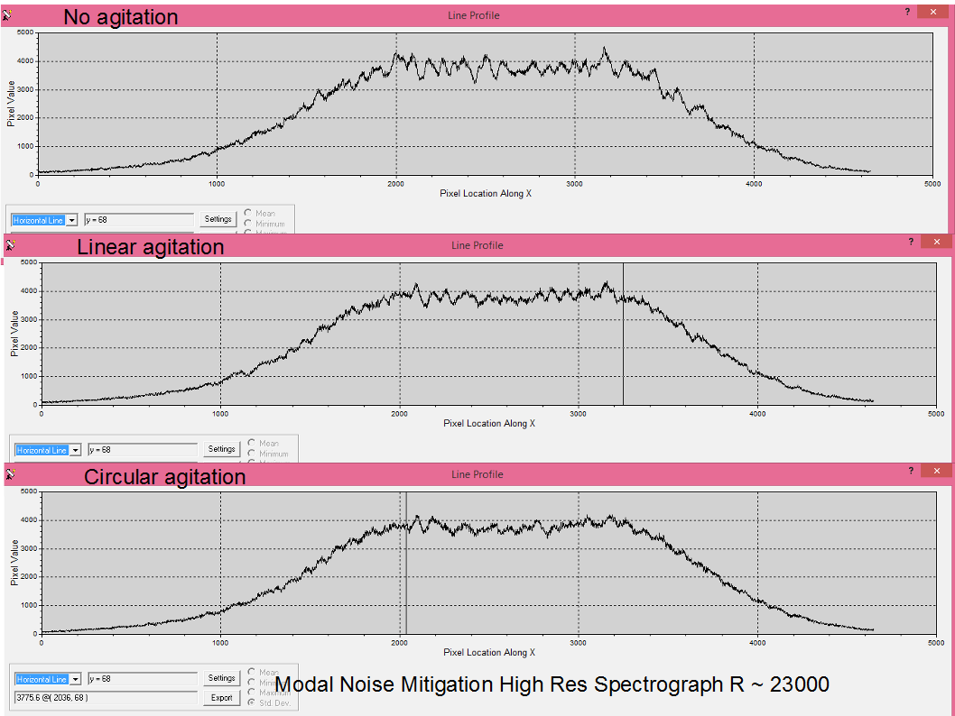

The original fiber agitator I had with the MRes spectrograph did not prove effective with the my new High Res spectrograph se my previous post. In view of this and taking advice from this paper https://arxiv.org/abs/1802.01642 I have looked at both linear and circular agitation (see results below) and concluded that I will build an agitator that provides both types of agitation.
Some key parts are on order but a key additioanl constraint is to have it enclosed so as not to attract an attack by my Burmese cat!
Modal Noise of Flats
Modal Noise Mitigation.png (253.77 KiB) Viewed 22629 times
The data is the same line through the average of 4 flats filtered with an average 3x3 Kernel filter as the camera ASI1600MM Cool greatly over samples the spectra.
I also still need to work to get the best from this camera.
Comments welcome.
Regards Andrew

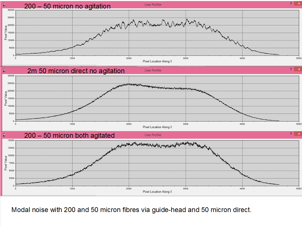

Thanks for your comments Christian.
Firstly it was a tungsten lamp with diffuser but as you will see this doesn't seem to be the issue. It was H alpha and I agree it did not seem to have the issue.
This lead me to do some more tests. Firstly with the set up with an 5m 200 micron fibre to the guide-head then 5m 50 micron to the spectroscope (as before).
Then I used a 2m 50 micron fibre direct from the tungsten lamp to the spectrograph. To my amazement the noise was gone!
I then reverted back to the first configuration but agitated both fibers with a much improved pattern.
I did do some other checks swapping fibres but it it seems it is the combination fibres and guide-head that is the issue.
Modal noise take 2
Modal noise take 2
Modal Noise 2.png (250.28 KiB) Viewed 22576 times
Note I did a 3x3 Kernel average filter to reduce the noise to better show the modal variations.
Any further comments most welcome.
Regards Andrew
PS Just ordered some 150 micron square fibre to try instead of the 200 micron circular fibre. Will report the results in due course.

After much research I concluded that the problem with the Flats giving a high modal noise was due to the Shelyak guide-head unit. Following discussions with Francois I sent the unit back and he realigned the feed from calibration unit onto the entrance hole.
Testing on its return shows I now have 5 time more illumination than before and the modal noise is significantly reduced so that "shaking" the fibre removes it.
Thanks to Francois for his efforts which were free of charge.
