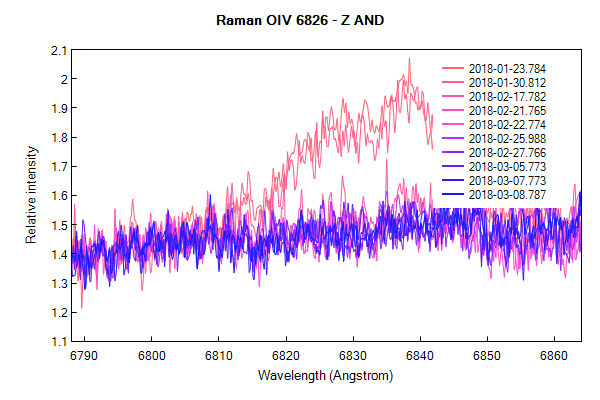

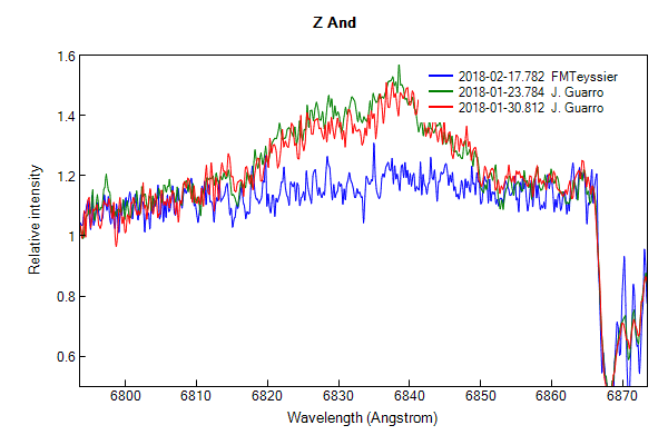

Echelle spectrum following VSNET Alert
In comparison to recent spectra obtained by Joan Guarro
Raman OVI has vanished
As did [Fe VII] (at least in comparison to the continuum)
Expected behavior for a classical symbiotic outburst

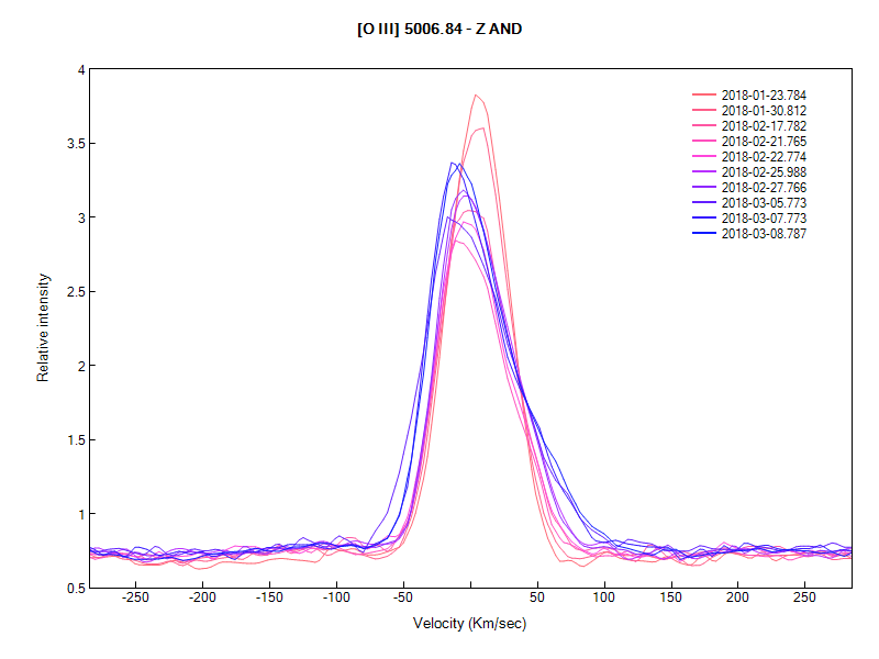

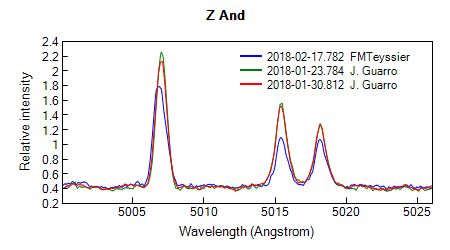

[OIII] 5007, He I 5016 and Fe II (42) 5018
Further observations are welcome

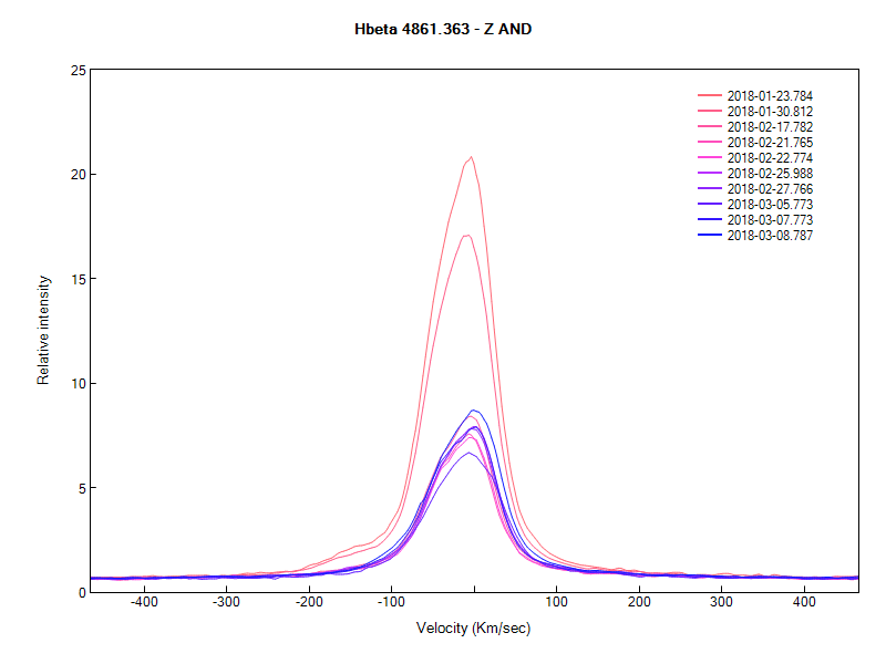

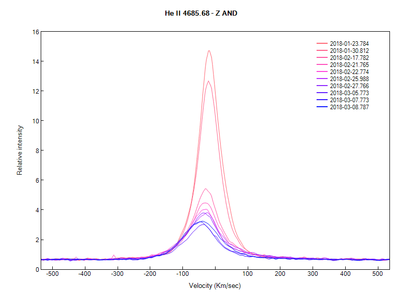

Re: Z And outburst
Posted: Mon Mar 05, 2018 10:51 am

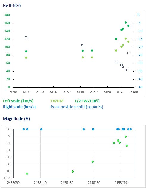

Observations during the outburst
He II line
From echelle spectra obtained by Joan Guarro, Tim Lester and François Teyssier
Significant broadening of the line and shift toward blue
Can be interpredted as the result of increasing wind from the hot component

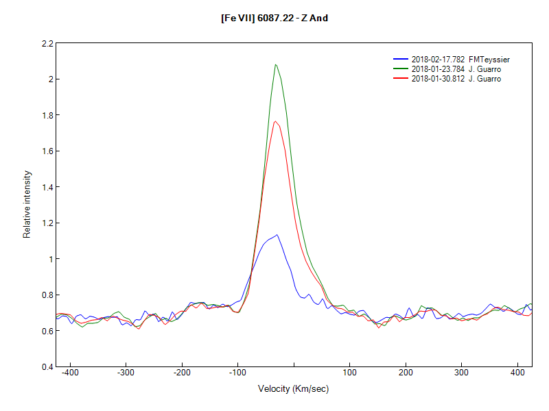

Re: Z And outburst

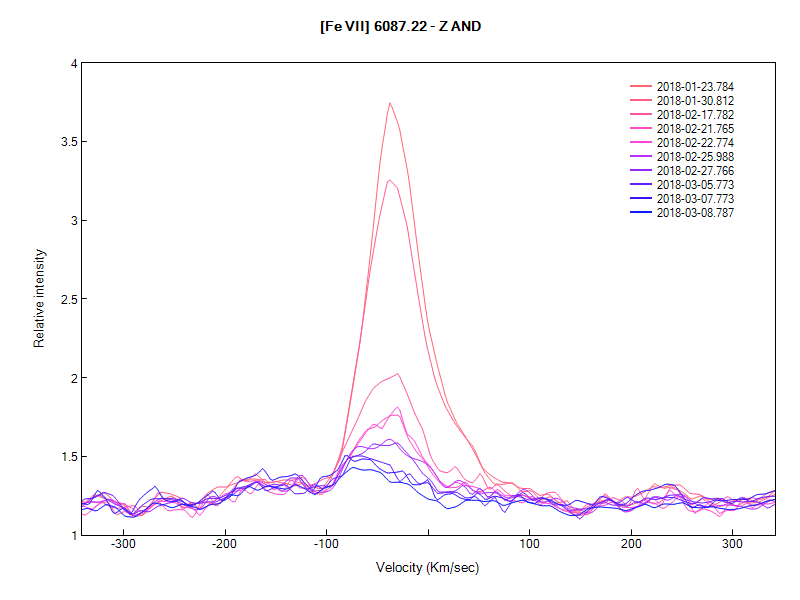

Posted: Sat Mar 10, 2018 5:34 pm
Monitoring of the outburst, (good coverage despite declining altitude of the star)
Echelle spectra obtained by Joan Guarro, Tim Lester, François Teyssier
corrected for heliocentric velocity
[Fe VII] still weakening
Raman OVI totally disappeared at the begining of the outburst
Blue shift of He II
No satellite lines (jet) in Balmer lines.
Unfortunatly, the star is lower and lower

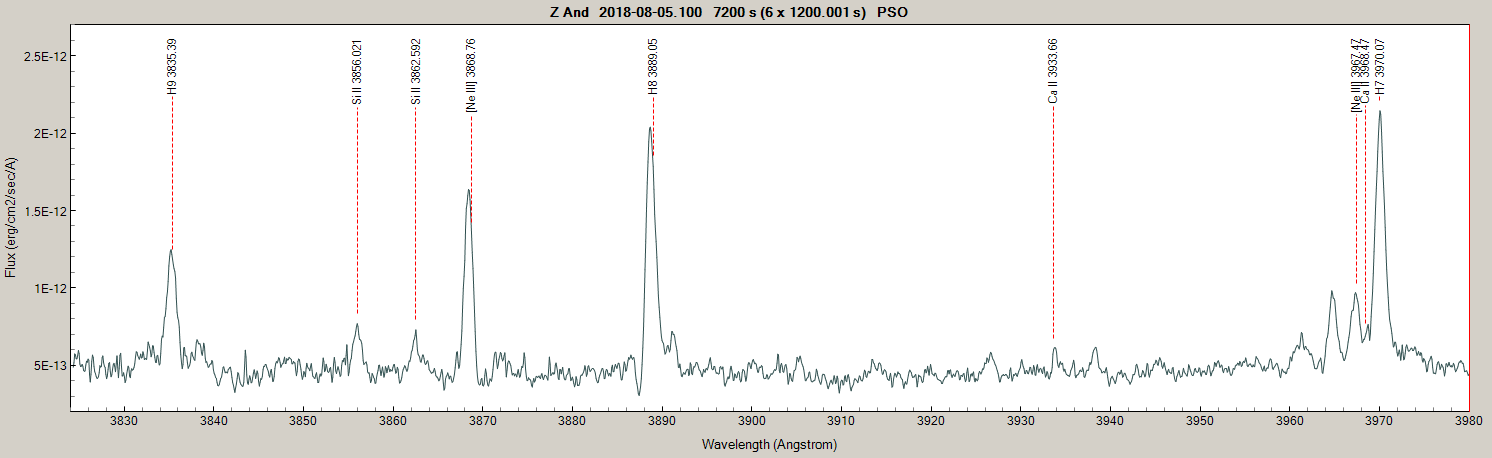

by Peter Somogyi
Congratulations Christian for the breakthrough!
By chance, I've also visited this object in the near-UV (12" Newton, LHires 2400/mm, 35 micron slit, R~5500 average) on the weekend:
(Flux calibrated with 2-stars method on 15 And (miles), using the wide slit.)
There is a real absorption (visible on all raw images) near to H8, going below continuum. However, I'm not sure whether if it's a P-cyg profile of H8, or just from a different feature (H9 is a bit unfocused, H7 is contaminated - they are not confirming it well).
The Si II annotation needs to be verified, VSpec shown match with 2 strongest out of the 3 lines, and saw these features on F type stars (in form of absorption) mentioned before.
- Peter
EDIT: uploaded the flux corrected spectrum
