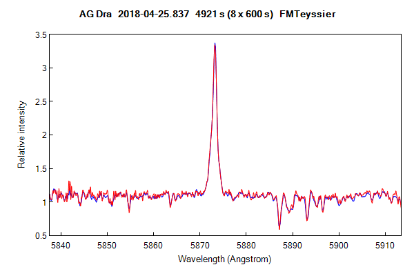

Traitement ISIS 5.9.0 (rouge) et 5.9.3. (bleu) avec toutes les options, sauf sum before (ASUS Republic of gamers)
Amélioration significative du SNR, sans altérer les profils des raies. Impressionnant.
Merci Christian !

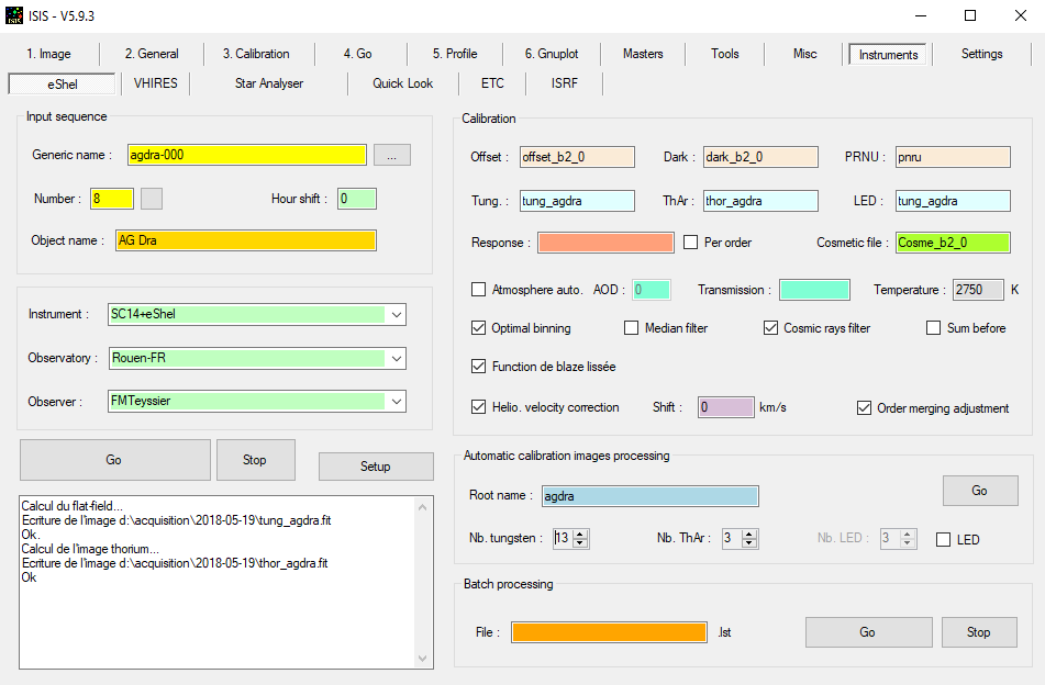

The artifacts that I was sometimes getting with optimal binning selected now seem to be gone.
One small problem though. The check box for Helio. velocity correction is gone and the box for shift is only partially showing.
This is what I see.
Re: ISIS 5.9.3 and eShel user's
Posted: Sat May 19, 2018 6:13 am
Hi Tim,
Strange
Did you check the version to be 5.9.3b in settings window?
Posted: Sat May 19, 2018 7:13 am
Hi Tim, your folder EN and FR (interface resource file) are really updated ?
