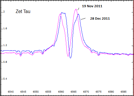

Looking at latest spectra from zet Tau, it shall be noted that the H-alpha profile is evolving in few weeks. Zet Tau is a binary star, always evolving, but this is always interesting to follow... Hope Ernst will bring us lights on this episode.

Hi Valerie,
are you sure, that your 2011-12-28-spectrum is really OK ?
My spectrum, only few days later, does show, that the V peak contains a triple-peak component and has the same hight as the the R-peak. I took it with the 2400 L/mm grating.
The appearance of the triple peak component is still a mystic sign. But Thomas Rivinius wrote me last year, that a triple peak component will appear only in a certain phase of the orbit of the companion.
Hopefully we have the chance (because of the weather), to continue this interesting evolution.
Best wishes, Ernst
